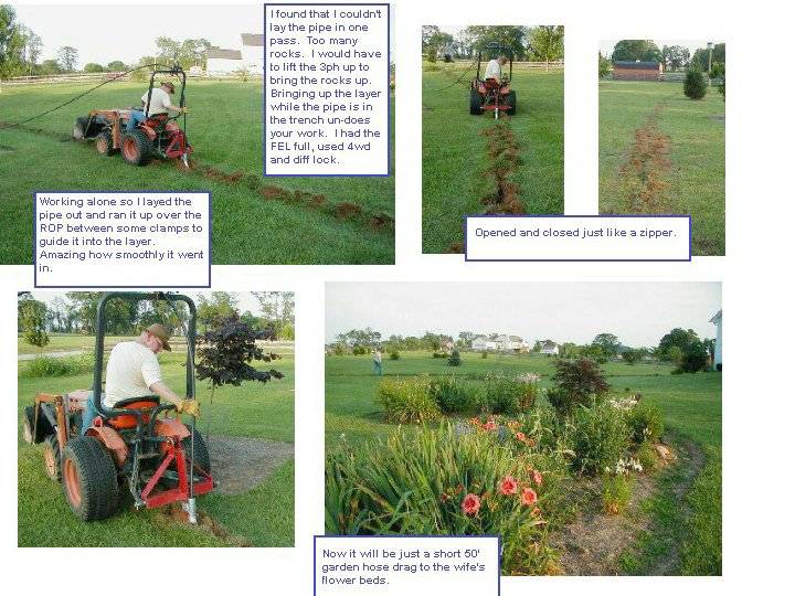

Here are a few photos I saved some time ago from a TBN thread. It gives a good idea of what's involved in the sub-soiler approach to this chore.
   / Water line installer #12
Last image.
