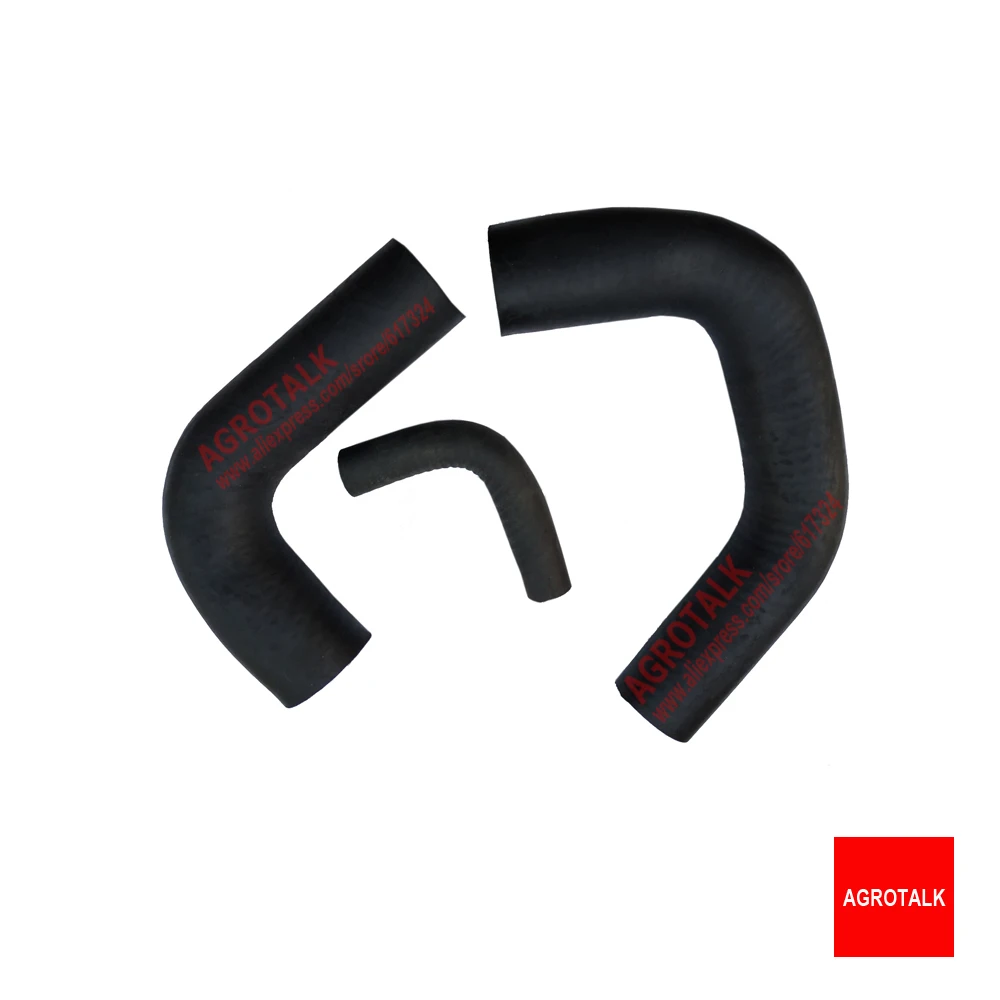

I looked back at my records, these were the items that I got from Ali Express
That was two years ago. The only issue aside from having to wait was an extra outlet on the bypass circuit to be blanked off, I guess that was for a heater circuit. The hoses needed a little trim as they were a bit long.

The replacement pump I got had the inside of the outlet threaded. Just screwed in a pipe plug.
If not, a short piece of hose with a bolt that fits and a couple of hose clamps should do it.

That third outlet wasn't threaded on the pump I received, just a plain pipe spigot. I blanked it off with a short bit of hose with a bolt plugging the end, obviously with hose clamps. A bit of a bodge. However there's a guy at work who's into rallying, and apparently in competition vehicles they're always blanking off unused bits and pieces. He pointed me to things like these, and one day I'll get around to neatening it up ...

Hello bevanski, I was a little apprehensive ordering one from Aliexpress mainly because the price was so low. I bit the bullet an ordered one and it was spot on. Even the extra outlet was blanked off. It was a straight swap. Cost me about £53 in total. Good luck with yours.
