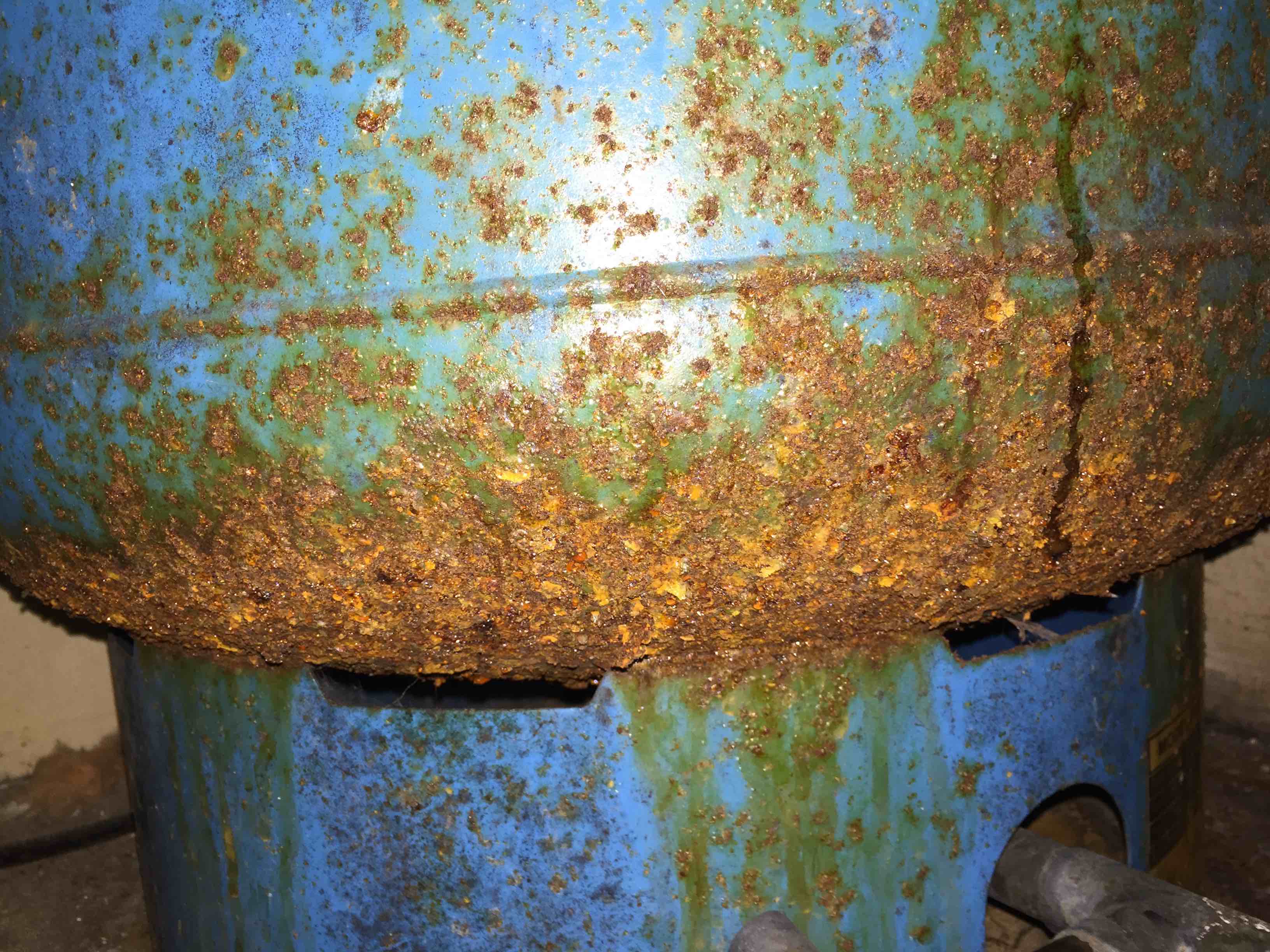

Check out costs for a separate tank & pump vs. a pump tank combination and then make a decision as to what you would like. Also check the water softener and see if the rinse water is going through the septic system. This could lead to field damage.
On the water tank wait till you have spare time and it's the start of the week; then scrape off rust and maybe do some wire brushing. That should give you an indication of material left/gone. Use a rust preventative paint on it if all looks good.

That is one sorry looking tank. I would change that and the pump. I don't think your tank will get any better.
350# of salt a month? Are you running a factory? That is nuts and there has to be a problem somewhere. Maybe the softener is recharging all the time for some reason. I thought I used a lot when I used 50# every 3 months, and I had pretty hard water.

I went down to the utility room to get a better look at everything and grab some timings during a shower situation. Nothing else was using water, just one shower. The shower would run for 2 mins 45 seconds before pressure would drop from 58 psi to 40 psi and kick on the pump. The pump would run for 50 seconds bringing the pressure back up to 58 psi (while the shower continued to run).
I then took a look at the pressure tank and whoa... I don't like the look of it. It is an AquaFlo 44G unit, but the bottom is covered in rust. I attached a picture below.
How much longer until this thing bursts? It may look worse that I think, but I can't imagine it should be absolutely covered in rust on the bottom like that. I assume it's just from condensation dripping and sitting on the bottom?
So now I'm sitting here thinking I need to replace both the jet pump and the pressure tank. The added pressure tank costs are probably a good $2-300. So now I'm wondering if I should:
1) Just buy another 44 Gallon pressure tank and swap it out or
2) Look at getting a smaller pressure tank/CSV setup for the new Goulds pump
I realize option 2 will have the pump running MUCH more often so I will really need to find a way to quiet it down (insulation, etc). What do you guys think?
Looks like you are storing that excess salt in the same room as the pressure tank? Storing salt or chlorine will rust out any metal in the same room or even close. Store the salt somewhere else.
Yes you can make a jet pump work similar to a CSV. The depth to water and the max pressure the pump can build will determine the pressure switch setting. When lifting from a certain depth if your pump has a max pressure of say 70 PSI, then you can set the pressure switch to work at 49/69, and the system will work similar to a CSV system. Since the max pressure of the pump is 70 PSI, it should only be pumping about 1 GPM at 69 PSI. That way the pump will not shut off as long as you are using at least 1 GPM. You could use a small pressure tank, and you would have good strong constant pressure, similar to the way a CSV would function.
However, there are problems with running the pressure switch setting so close to the max pressure the pump can produce. Since 2.31' is the same as 1 PSI, if the water level in the well drops 2.31', the pump will not be able to build enough pressure so the pressure switch can shut it off. It will just sit there at 58.5 PSI until the water gets hot and melts the pump. The same thing can happen if the pump wears by just 1%.
It is much safer to work the pressure switch further away from the max pressure the pump can build as with a CSV. The pressure switch can be set for 40/60 instead, while the CSV will hold a constant 50 PSI, which keeps the pump from cycling as long as you areu sing more than 1 GPM. Shutting the pump off at 60 gives plenty of room for a little drop in water level or wear iin the pump without causing damage, plus you can still use the smaller tank.
A cast iron pump with good motor bearings is as quite as you can get. A little back pressure from a CSV usually quitens it down a little over running flat out as it does without a CSV. Rubber feet for the motor mounts and a short piece of rubber hose on the discharge side of the pump really help keep the sound from transmitting to the pipes and walls. An insulated box over the pump will also block noise, but you have to have some ventilation and air flow to keep the motor cool.
