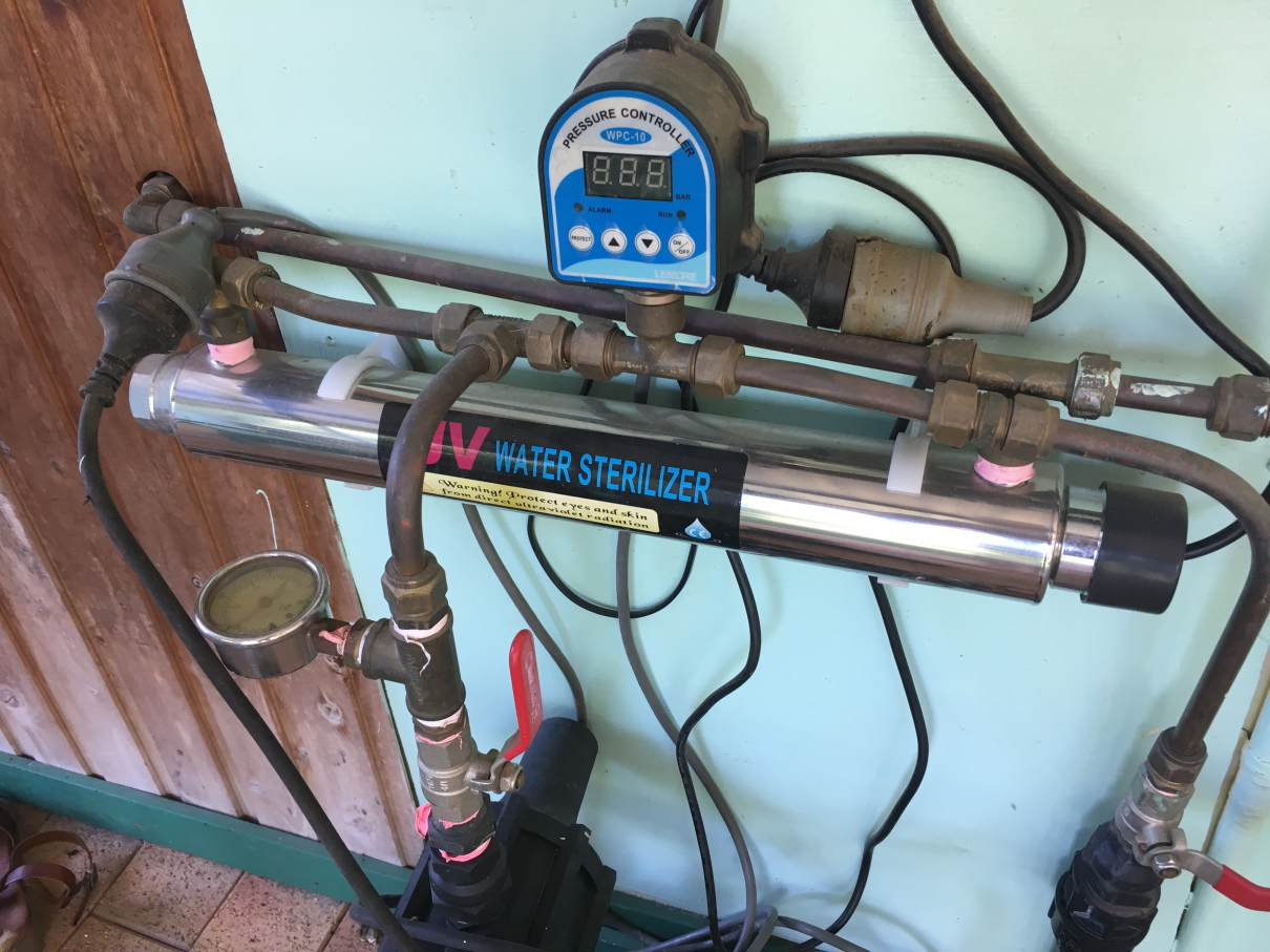

We fitted a UV sterilizer to ours. All water, (tank or bore) goes through it. Instantly kills anything that may be harmful. The UV light switches on as soon as a tap is opened. Not cheap, but if you are serious about safe water it is the way to go.
   / water purification #12
UV sterilization is really nice but only addresses pathogens (bacteria and viruses)- chemicals can only be addressed using mechanical filtration means.
So it really depends on the types of contaminants as to what filtration and/Or sterilization mechanisms will need to be applied to ensure potable water.

We have filters in line first but we have no chemicals etc in our bore water. I do PPM TDS checks every now and then as well.
