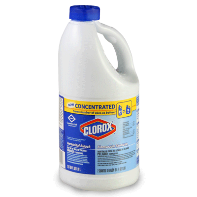

Unfortunately I believe thats not true anymore. Thats what I'm finding out now. Thats why the chart that I had is now incorrect and my dosage is way too strong. If I remember correctly, the old number for the active ingredient (the chlorine) was 5.25%. Sorry if the picture is fuzzy, I just quickly googled it, but its now 8.25%:
Notice the yellow band stating Concentrated? Thats all I can find in the aisles now at walmart, lowes, home depot, etc. All stating the new 8.25% concentration. I'm not a math whiz, so I don't know how much to add now, but it would seem MUCH less

But - Clorox is Clorox, i.e. bleach, no matter what label is on the bottle. And, Lesson Learned, a little bit goes a long way.

BTW: 1 tsp of Chlorox per gallon seem like a lot by an order of magnitude.

About 1tsp/gallon of water is what is used to sanitize RV water tanks. (1/4cup per 15 gallons of capacity is the formula). You let this site for a few hours/overnight and then flush and refill with clean water. That seems like a lot if you are actually going to be using the water. I just did some quick searching and it looks like the various 'prepper' sites list a formula of 3 tablespoons to 55 gallons of water for disinfection and long term storage of drinkable water (they recommend changing the water every 6 months).
Make sure you use 'unscented' bleach as it has no additives.

"Clorox" is jut a brand name & you pay for it. My friend gets his by the case at A discount club. (Sam's I think).
For a 1,000 gallon tank about 1 pint should be about right.
I made a mistake on his big tank size, they are about 5,000 gallons each. 1 Of those is what he adds a gallon too. The 1,000 gallon is the pressure tank, but that is the tank the water is tested out of.
If you add a pint & water smells or tastes bad. cut the amount down. While experimenting you may want a few gallons extra for drinking & cooking.

Hope I didn't misunderstand earlier about "clorox is clorox". I understand that is a brand name. I was only trying to point out that now there seems to be a difference in concentration, not between products or anything. The concentrated label is applied to all brands now as far as I could tell. Even the generics.
