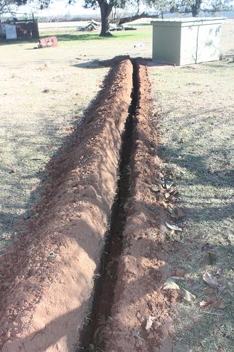

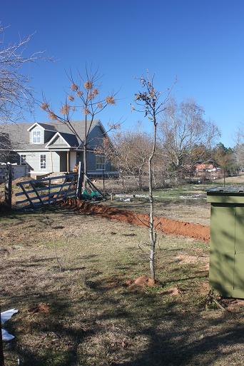

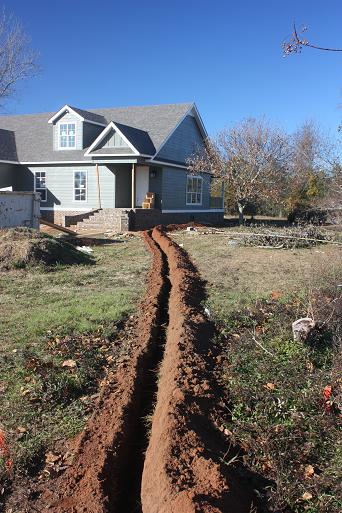

I'd go at least 3 feet down with the pipe. Any shallower and you could dig it up accidentally or damage it by driving over it. It's easier to bury it deep the first time than it is to repair it twice, then decide to bury it deeper.
Any PVC pipe rated for potable water should work fine for you.
I use the black pipe for outside use--like watering the yard or garden. I use white PVC with the designed glue for PVC.
Black pipe if not one long length than you must use connectors and clamps---this tends to rust and leak over time.
Some people use black pipe for the hot water line and white for cold water and potable.

   / Water supply from well to the house #50
What RickB suggested is what I would go with and is most likely the pipe used to go to the well. I would go deeper then 8 inches. So as not to dig it up or should you need to drive over it. You should also check with the city/county because most likely you have a 220 line running along side the pipe code most likely is 18 to 24 inches for electrical wire and if going under a cement walk/driveway at least were I am at ther is different depth/rules. On the electrical wire pumping houses will cut the wire to length, so you do not need to splice the wire.
I would use brass fittings and 2 clamps at each connection on each side, cheap insurance. Heat gun works great making it easier to get brass fitting into pipe. I would also put a check value in the house, between the pressure switch and the pump. This way if the pipe gets a hole in it or the check value on the pump goes, you will not burn up the pump.
If the pressure tank is the basement and you have plans in the future to finish the basement, put the out of site disconnect in now.
For future reference if some day, the pump does not work. Check the little pipe on the pressure switch often this gets plugged.
Sorry if this is more then you asked for, but can not hurt to make sure you know this.
I agree with the above quote. In short:
  • 200 psi black polyethelene water pipe. 1" and 1-1/4" are common sizes for water lines around here.
  • National Electrical Code requires minimum burial of 18" for electrical line on residential property. Your state or local codes may have additional requirements which should be followed.
  • Might as well put the wire and the well line together at the bottom of your trench, far away from future digging (by you, or especially by others in the future).
