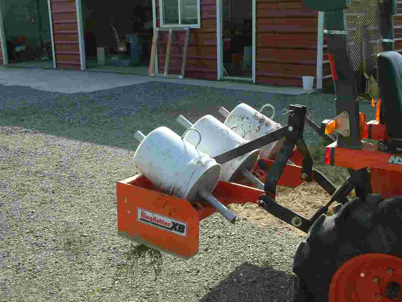

Just brainstorming here (talk about a tempest in a tea pot;) ) but I was wondering if anyone made, or knew how to make, some sort of water tank that would attach to the three point hitch for ballast. I realize that water only weighs 8 pounds per gallon, but something the size of a 55 gallon drum would give you around 440 pounds on the rear. I see several advantages to something like this. First, easy to handle. You can fill it once you have it attached. When empty, it would be easy to move by hand. Second, it would allow you to simply transport water if you needed to. There were several stretches last summer when it got real dry here and I was concerned about a couple of young trees dying. I carried water in the bucket to water them. That is slow and tedious (water slops out). Just a thought. Probably already been done, but anyone have any thoughts?
I prefer concrete (130-140 lb/cu ft) vs water (62 lb/cu ft).
Here's the ballast arrangement for my 21-hp B7510HST/LA302 FEL. That's three 120 lb concrete weights and about 250 lb of box blade. Imbedded U-bolts and fence post pieces help get a grip on the weights. Get's the job done.
Good idea, but he was also wanting to water his trees.
