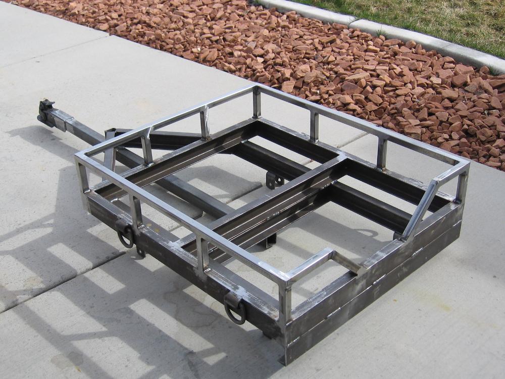

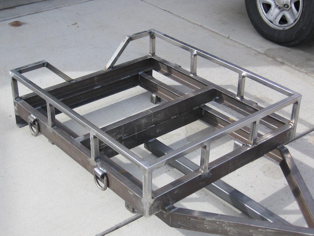

A couple pics of the finished rails...

It looks to me like maybe you've done this sort of stuff before. It looks really good.
   / Water Trailer Build
#25
Not really as far as trailers go, mostly off road trucks.
#28
Cory, very nice fab job! I like the rails and how you angled the back ot accomodate the valve. Good job!:thumbsup:
That was my boy's idea. I was going to have it go straight across with a caged in area to protect the valve. He pretty smart...for a kid.:thumbsup:

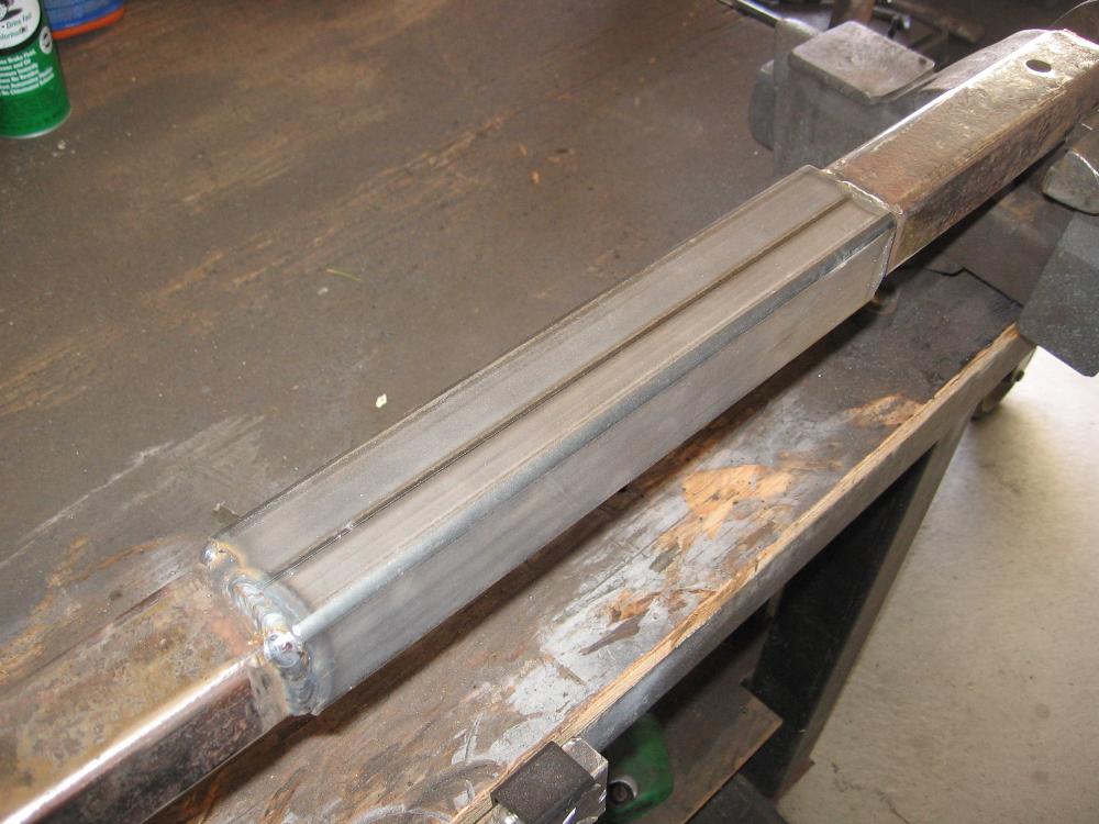

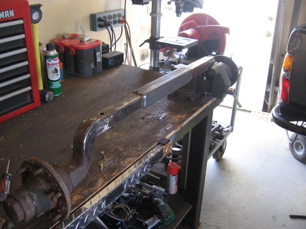

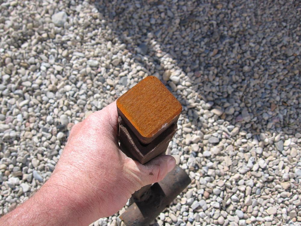

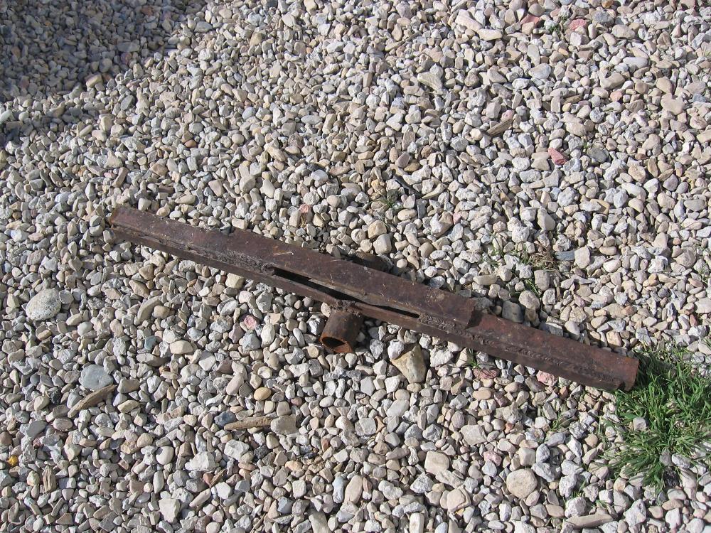

Finally got a little time to work on the trailer today. I focused my time on preparing the axle for paint. The axle sat on a farm for the last 40 or so years waiting to be built into a trailer, but the owner lost interest, so he said I could have it. The first pic is the monstrosity that was welded to it that I cut off to get to the good part. Second pic shows that the axle is 1.75 inch solid steel. Way hefty. I sleeved it to the correct length with 2X2X.120. It slid right in with just a touch of grinding.

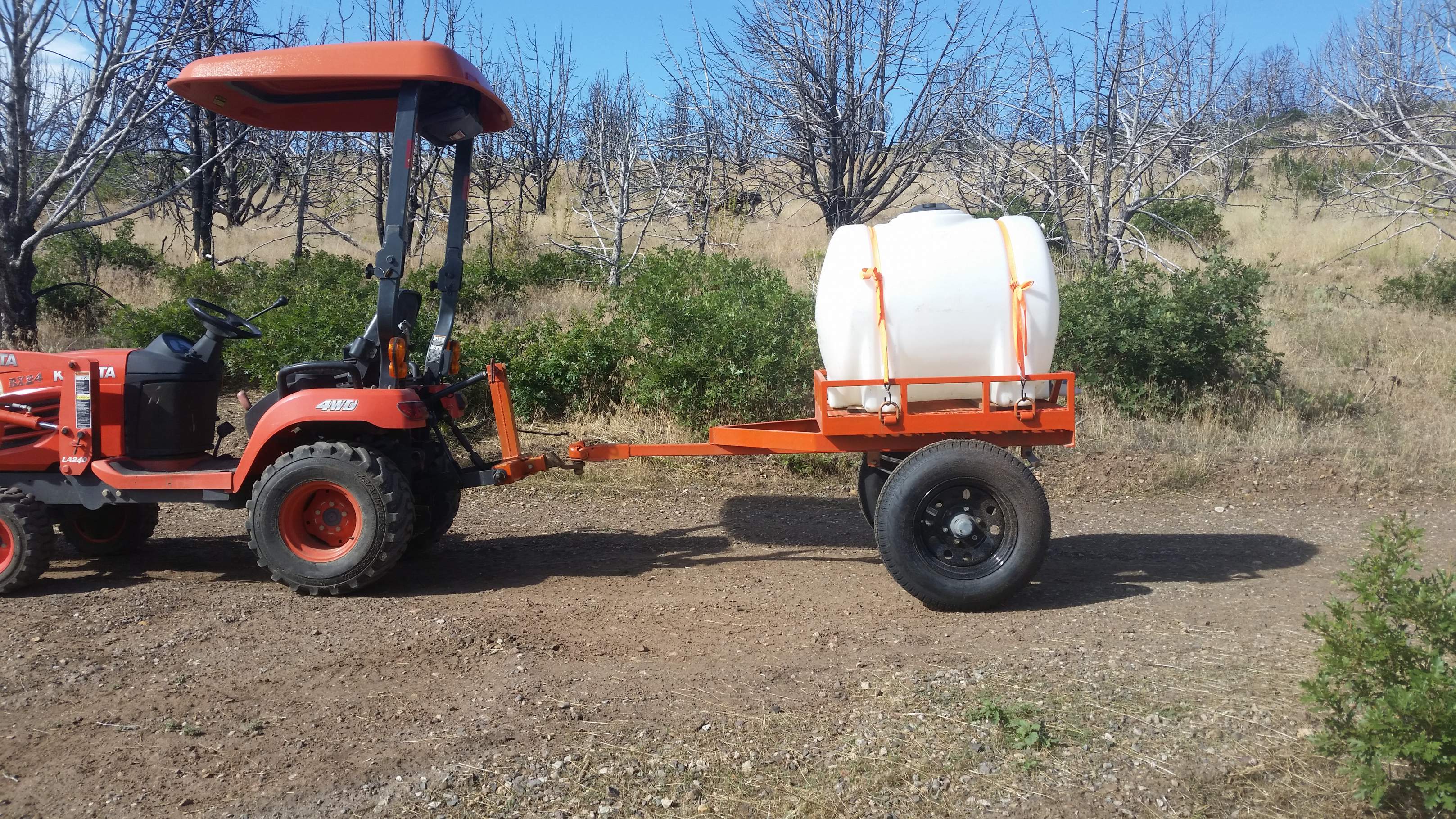

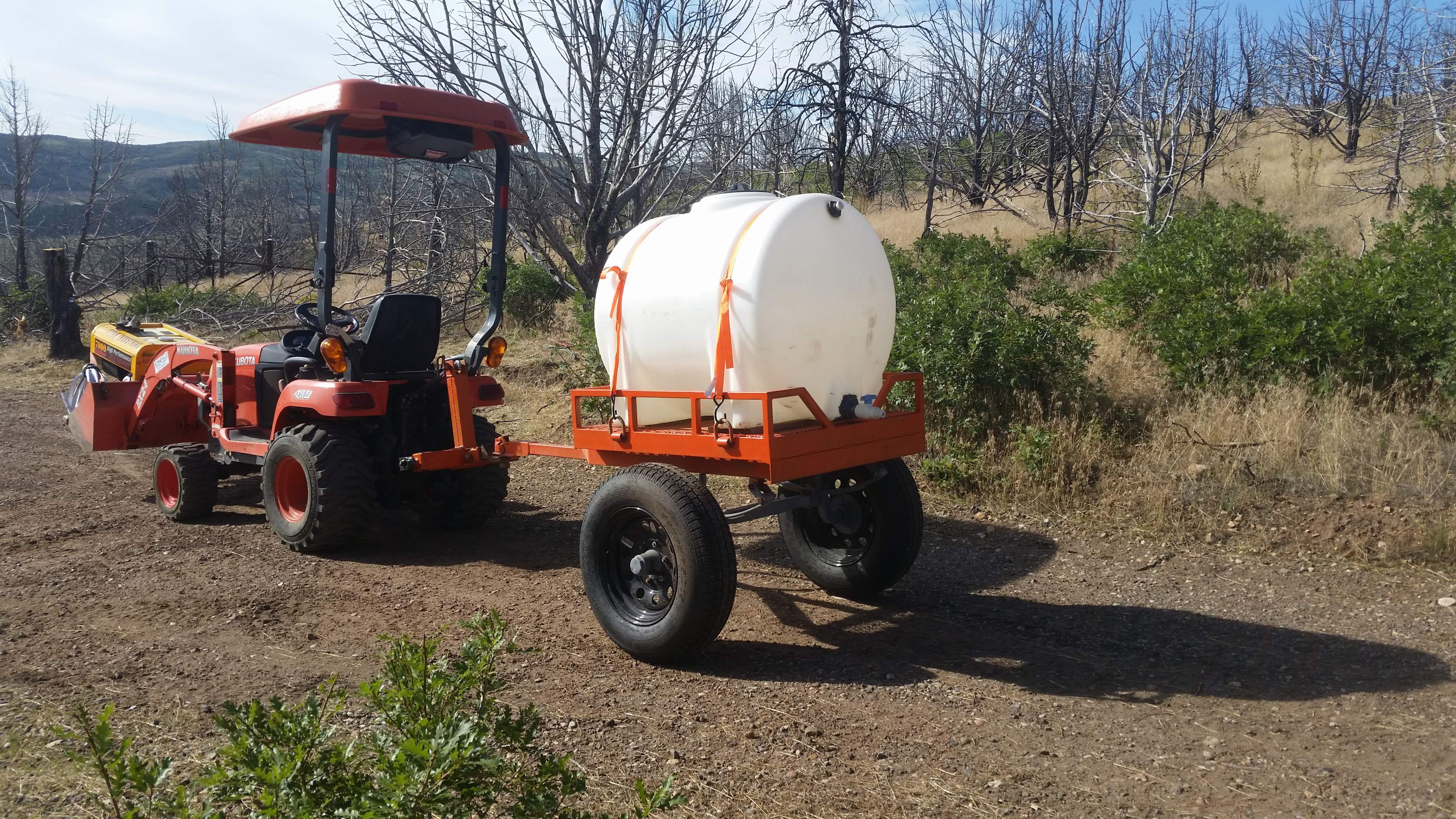

Was just looking at this old thread and realized that I never included finished pictures. So here we are, 5 years later, with the trailer in use. Luckily, the trailer was at home for maintenance back in 2012 when a wildfire burned through our property, so it was one of the few things that survived. Pics...
