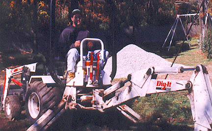

and here is the rental machine that made it all possible . This little dig it just kept on going.

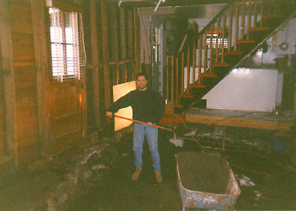

Now if I just could have fit the Dig-It thru the front door I would have been in heaven. This the only digging machine I ever owned!! Sometimes I had a hard time getting this machine started../w3tcompact/icons/laugh.gif

I've got a digging machine like that some where. Have not used it much since I bought the bh.
If I could drain mine out like yours maybe i'd go for it, but the way it is - no way. That digit looks like a sweet machine for bh work.

yeah my manual digging machine ignition isnt as reliable as before and I got tired of paying to rent a machine. Then rushing for a week to get the job done rain or shine. So I`m finally breaking down and buying my own Kubota. I just wish it would get here. I feel like an anxious kid. /w3tcompact/icons/laugh.gif That dig was a good little TLB much better than the terramites.
