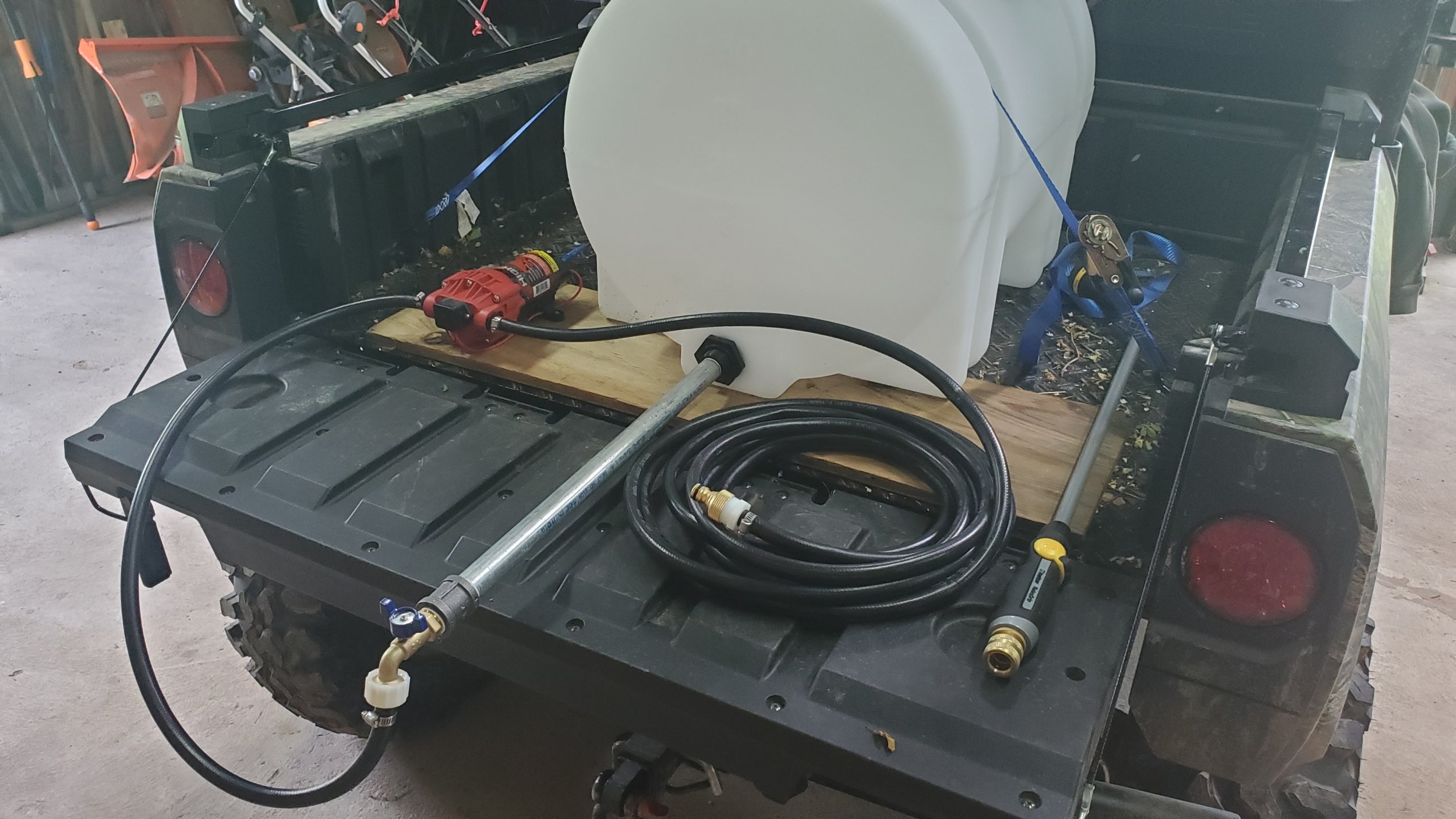

This was all set to go and the fitting to the pump broke before I could try it. Damn Chinese POS stuff.

If I could make a suggestion, I'd suggest getting some radiator hose from the auto parts store because it won't stress those fittings like poly pipe. I'd do away with the long galvanized pipe and come out of the tank with the water shutoff to the pump which I'd relocate to the right side so there's a more direct run from the tank to the pump. If there isn't enough clearance for reusing the shutoff valve in this position at the tank, substitute an elbow along with a metal ball valve. The ball valve will allow better water flow than a spigot style shutoff.

I ain't spending no more money. If it works, it works. All I want to do is water the garden.
