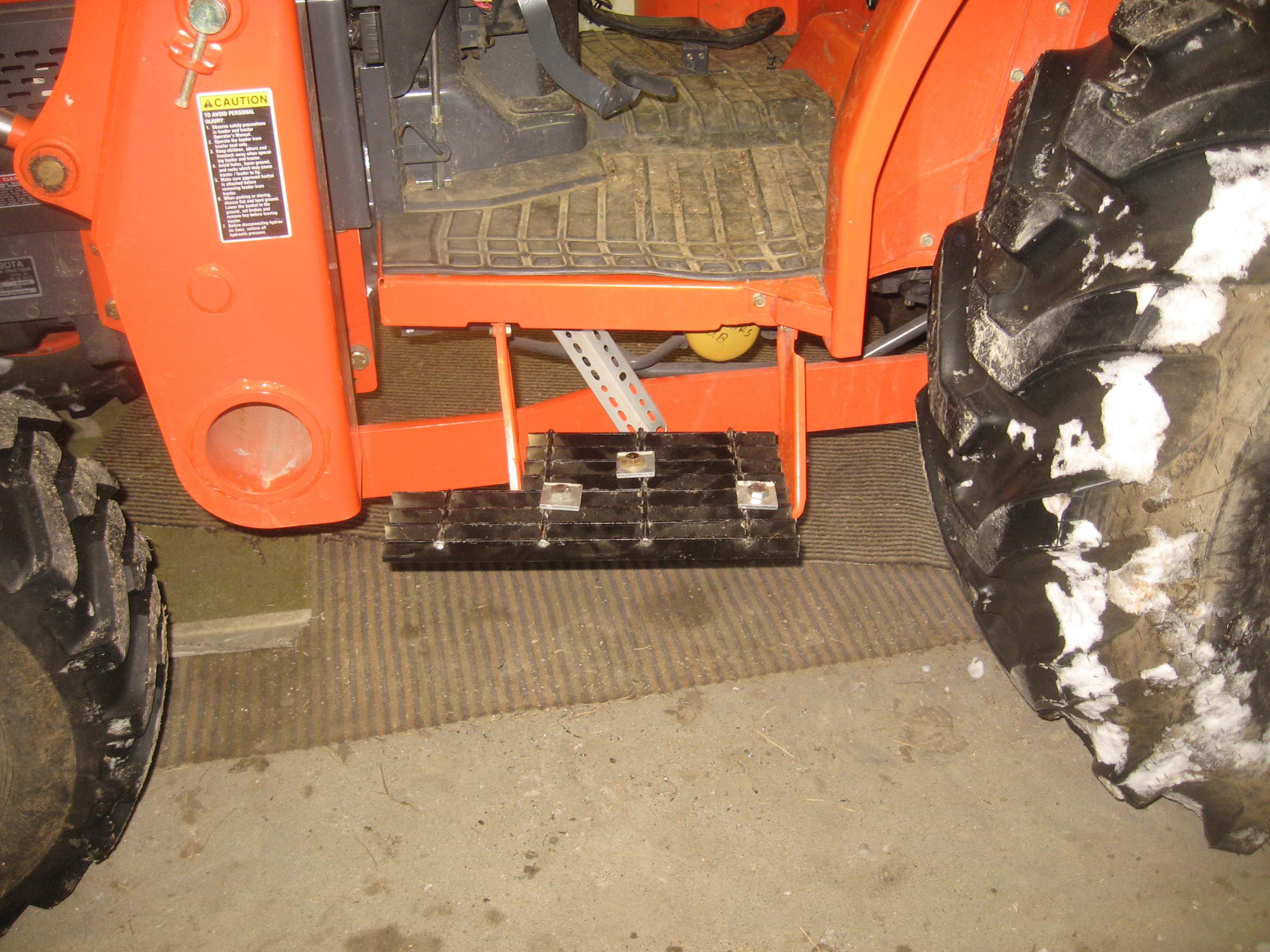

On my 3240 it's a long drop to the ground when getting out of the cab and I'm only going to get older. I always wanted to add another step. I was going to order another one but why wait for one to come in. I took both steps off which are both the same. I cut the first step off the frame cut it down 1 inch and welded it back on the mount before cutting the next step off the frame. This way I can have a pattern for the same angle.
So it's five inches lower then the original step and 13 inches off the ground (was 18 inches) but Oh so much more comfortable getting in and out. The subframe is 12 inches off the ground so it's not the lowest thing hanging down.
Will I bent it , knock it off? Who knows? I don't worry about hitting telephone poles with the fender of my car and I'm not going to worry about hitting the step.
18 inches is a big jump down the extra step just makes it easer. I still have to paint it
Is the frame of the upper step and mounting point on the cab strong enough to support the second step? When I have tried adding a second step onto an upper one, it sticks out farther from the cab than the original step and the torque of the second step really makes the upper step and mounting point flex. I usually end up adding reinforcing bars back to the tractor frame for the second step.
This step all I did was add more surface area, and it moved the forces out farther from the tractor, and I had to reinforce the step frame accordingly.

My brother made this modification on my L5740 HSTC and have had no problems to date, we initially thought additional bracing would be needed, but no problems so far.

Best thing I did to the tractor was to double up on the step.
As you show in my pictures, I cut the first step down a little first. The second step is also shorter then the original. The second step comes off the same angle as the first step, so as it goes down lower it also goes out further as it goes down. I think if you doubled up the two original length steps it would be too low, and stick out too much. That being said TripleR did his that way and it works for him.
I didn't need a wider step but a lower one. I believe my double step is only 5 inches lower then the original. But it makes a big difference.
It's a pretty strong mounting area on the Grand L 40 and does not flex. I'm 235 lbs and no problems for about a 100hrs of use.
I also added two pieces of 1/8 2 inch flat stock on the sides of the double step so you can't tell its two steps welded together makes a smoother cleaner look. But it still mounts up as that factory step did with no other brackets etc.

I think by extending the step out as you did in your picture, is different then bringing it down at the same angle as I did. You made yours into a right angle. So there is more leverage. It's hard to tell from your picture how far it sticks out.

I like the bigger surface area on DWTools step, it is similar to the OEM on our M8540, I may look into doing something similar on mine someday, I have "drop-foot" and worry about stepping through.
