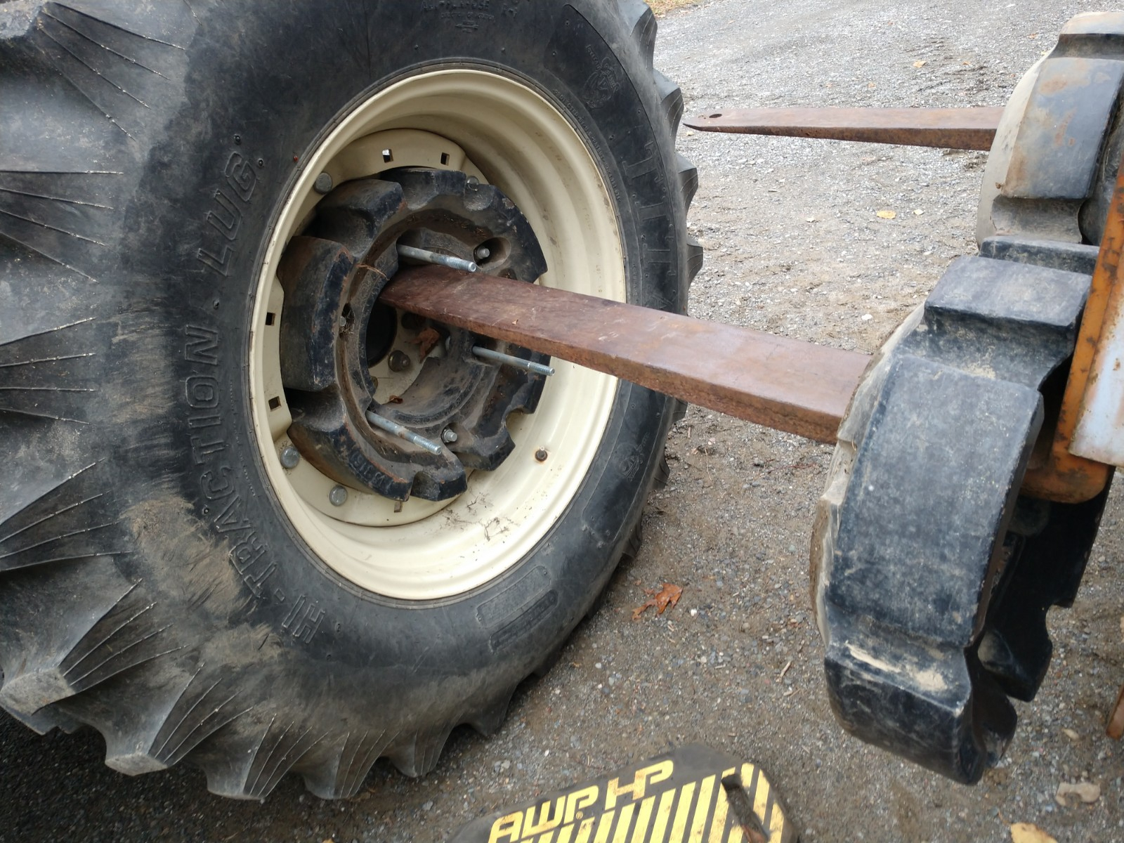

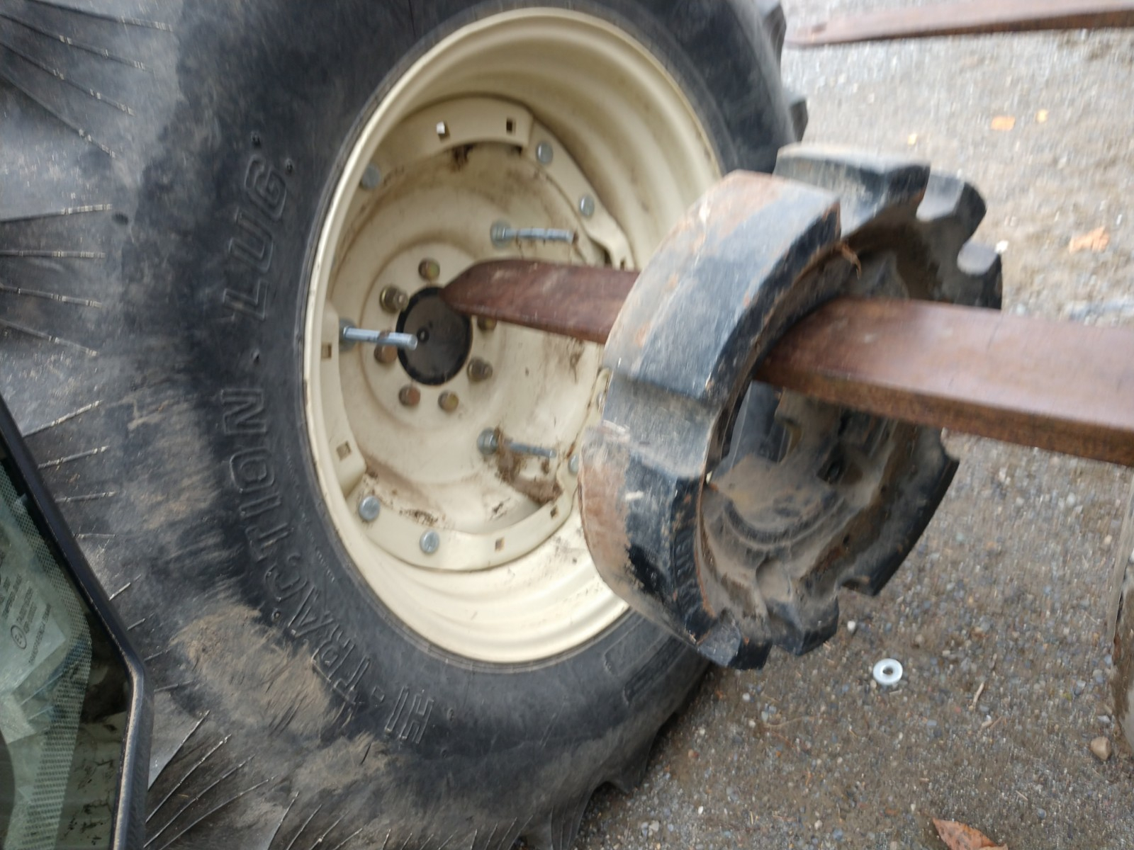

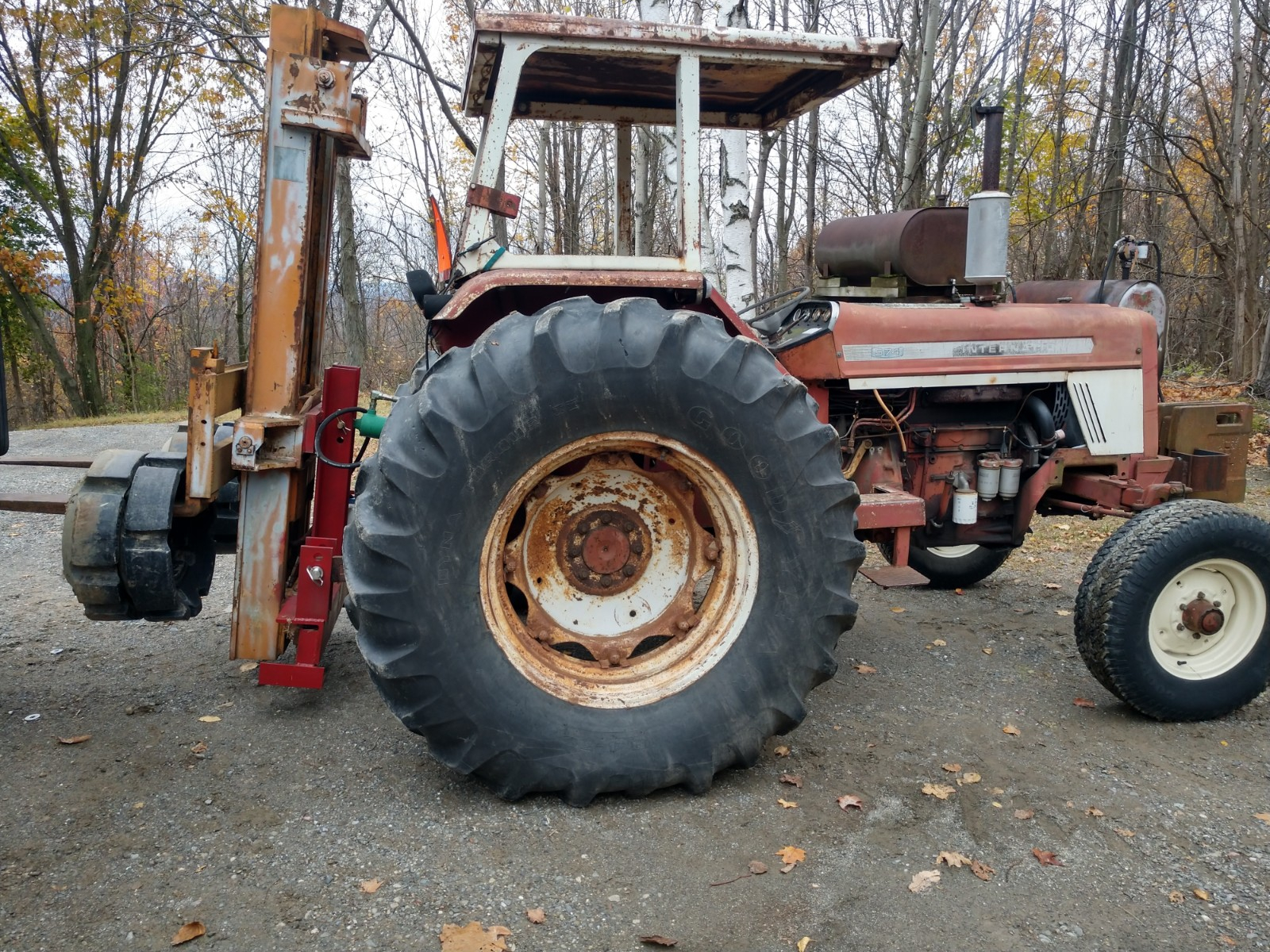

Had a neighbor that was a plumber that acquired a very large amount of lead.
He made some steel housing in the shape of wheel weights, then melted the lead
and poured those forms full they were extremely heavy for there size.
These are my 300# each wheel weights, I had to remove them to adjust the width of my tires then reinstall them,
the last picture you can see that the front wheels on the 574 are just about skimming the ground.
