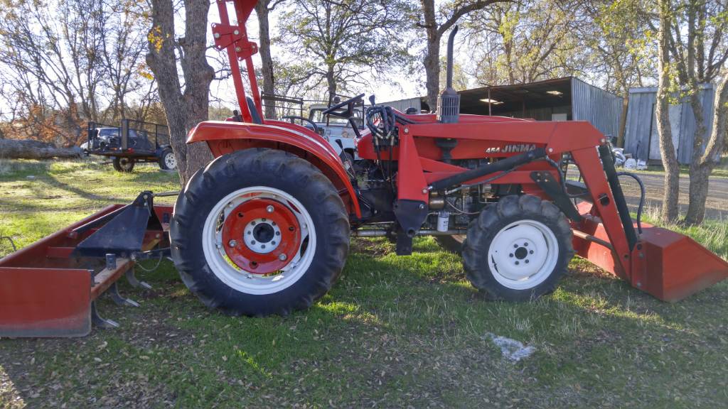

Yeah the chain they show in pic kind of light weight I use a 5/16 towing chain I keep in tractor tool box. I also have two chain hooks on loader seems to work ok with my rig. 1204151444_HDR.jpeg
