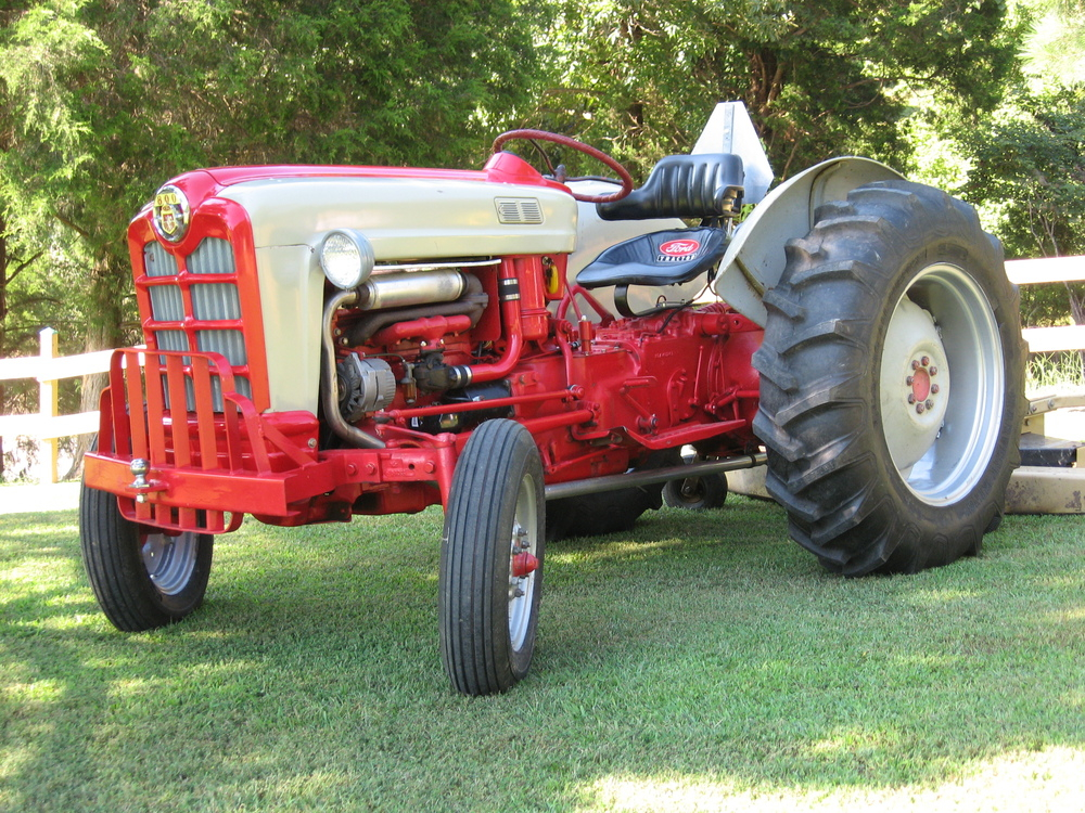

My nephew is restoring this 860. It was his father's (my brother). He started the restoration but passed away before getting much done other than disassembly and ordering parts.
   / We have a 9N, 8N, Jubilee, and NAA. Are interested in a Workmaster and what came after a Workmaster #9
Reminds of how mine looked about 10 years ago, after rebuilding the engine I cleaned and painted it. Still looks good today , mostly dirty with just a few battle scars from bush hogging in the woods.
