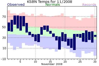

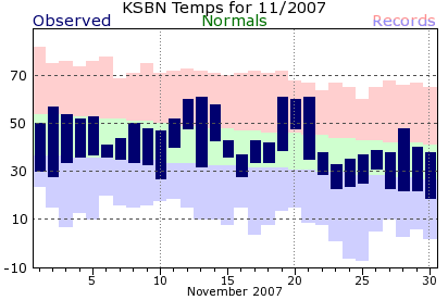

Well, the results are in. November 2008 was considerably colder than November 2007, especially the last two weeks, yet we used only half the gas last month as we did a year ago November. And that was my goal... to reduce our natural gas usage by half during the heating season. Attached are the temp charts for my location for the two Novembers.
