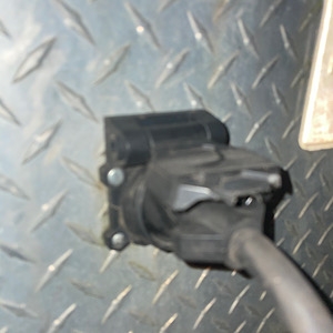

Over on the HD Ram forum they say one of the types of 7 wire trailer plugs is incorrect.
In the attached picture the correct version is on the right side.
I have trailers with both types, I prefer the double contact plug.

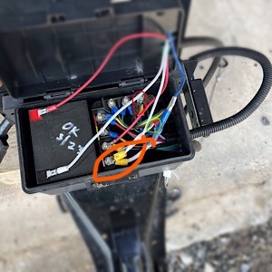

Wouldn’t that be in the 7-pin plug?
They do have a self tapper on the trailer itself
The 7 pin plug has a larger diameter wire (orange circle) that does go to the truck. One wire goes to the breakaway disconnect switch, one wire to the brake negative side. Where is the trailer actually connected to the truck wire? Probably the one zinc coated self tapping screw after it goes to the first set of brakes. You may find another self tapper (or two) on the rear by the lights.
As someone else mentioned, replace these with a bolt and nut, sand the area, then respray after assembly.
They both will work, the one on the left gets a bad rap because the dual contacts sometimes get too wide. A little tweaking with a small screwdriver can remedy that.
I also tape the plug into the socket with a couple wraps of electrical tape, cheap insurance to keep it from falling out. The springs on the covers go bad too.

Noticed trailer brakes are weak.
Battery box says “recharge” on battery, but battery is only 2 months old and electrical tester reads 12.4V
Brakes work, but don’t do a lot, even with brake controller fully cranked to 10.
The trailer is only a year old and brakes worked well when I first got it.
What should I start looking at? Wiring connections seem fine
The breakaway battery does not provided any braking capability under normal operation.
Looks like 2 issues.
a. the break away battery is not getting charged from the tow vehicle. It normally gets charged either from a dedicated cct from the tow vehicle, or off of the clearance lamp cct from the tow vehicle. Is your tow vehicle configured to supply charge to the breakaway battery on a dedicated cct or via the clearance lamp cct. You are going to need to chase the cct or ask the trailer vendor & who every wired your tow vehicle
b. elec brake functionality on the trailer can be impacted by:
1. controller settings (incl fuse condition)
2. trailer plug connection (clean & make sure they make solid contact on the elec brake AND earth cct)
3. actual wiring condition on the trailer - crawl under and inspect the wiring for damage
First up check the brake controller fuse, then check the trailers brake functionality use a multi meter to measure voltage with the controller turned to MAX setting & engages (not this may not be the normal usage setting), wrt to the wiring earth return:
a. voltage on elec brake cct on the back of the vehicle with trailer lead disconnected
b. voltage on elec brake cct on the back of the vehicle with trailer lead connected
c. voltage on elec brake cct on the trailer where the wiring splits to service each axle / wheel.
d. voltage on elec brake cct on the trailer where leads go into each trailer wheel hub
if you not getting 10V or more when the brakes are activated you have identified an issue from the brake controller to that point.
