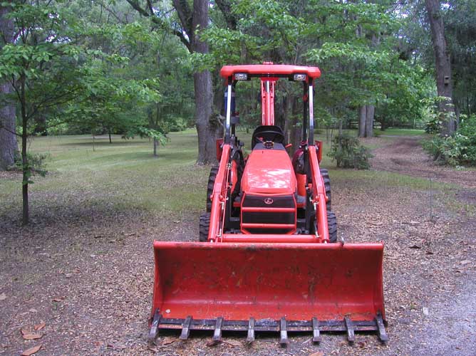

Here is a pic of the bucket, you can see the snapped off 3/8" clevis grab on the left hand side of the bucket.
It was welded on with my Millermatic 210 MIG welder and the steel clevis snapped in 1/2.
I don't think anything less than 5,000 pounds could do that......

Thanks for the Info SkyPup!
The way the loader is behaving, there is no way my L39 could handle the toothbar, it does not have enough ommph!
I hope that soon my loader could be strong enough to break a chain or hook.
Only way it could do it now is I got a **** of a running start in reverse!
   / Weak Loader on my new L39! What is going on? #6
BTW, the weld on that 3/8" clevis grab held good, the weld is still there, it was the clevis itself that snapped in half! /forums/images/graemlins/blush.gif
Also, that is a custom super heavy duty 1 1/2" shank toothbar that weighs 140 pounds, the toothbar on my LA723 FEL on the L-3130 weighs less than 1/2 that.
