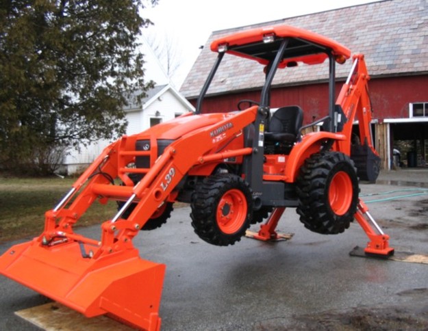

Again please confirm the loader will lift the front tires with the stablizers extended?
My TL1000 won't lift the tractor with the stablizers down.

Mike,
Just to answer one of your last questions.... /forums/images/graemlins/smile.gif My L39 will easily lift my machine with the stabilizers down. It's not the slightest struggle, with zero hesitation. Picutre was taken a few months back and posted previously.

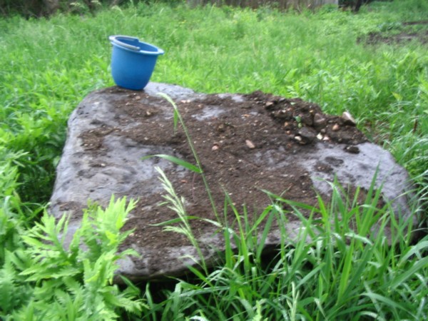

Here's another of a massive rock I moved last week. It didn't lift it very much, but I was able to move it. I put the water bucket there for scale. Big boulder for any small machine to handle.

Nice pic of that rock Jim, I know that thing weighs allot as nothing weighs more than solid rock except maybe wet cement. I'll post some unbelieveable rock moving photos here soon as I have been decimating our many rock gardens with our L39. /forums/images/graemlins/grin.gif

Jim,
how did you manage to pick the rock up? I can't seem to get the monsters into the la723 bucket and I have to use the curl and lift and push and roll and I end up riding them like a bronco sending them end over end. In fact I am not successful at getting most stones into the bucket even the ones that will clearly fit in. Is there a technique you could share?
Thanks,
Martin
   / Weak Loader on my new L39! What is going on? #20
Martin, I MIG welded two 3/8" clevis grab hooks onto the top of the FEL bucket.
Then you just nestle the large rocks and boulders into the bottom of the bucket with the toothbar and then wrap a 20' 3/8" grade 80 chain around the boulder and use the curl to lift it back into the bucket, works great on our L-3130 with LA723 FEL and the L-39 with the TL1000 FEL.
This works allot better than attempting to simply dig and grab the rock with the FEL.
