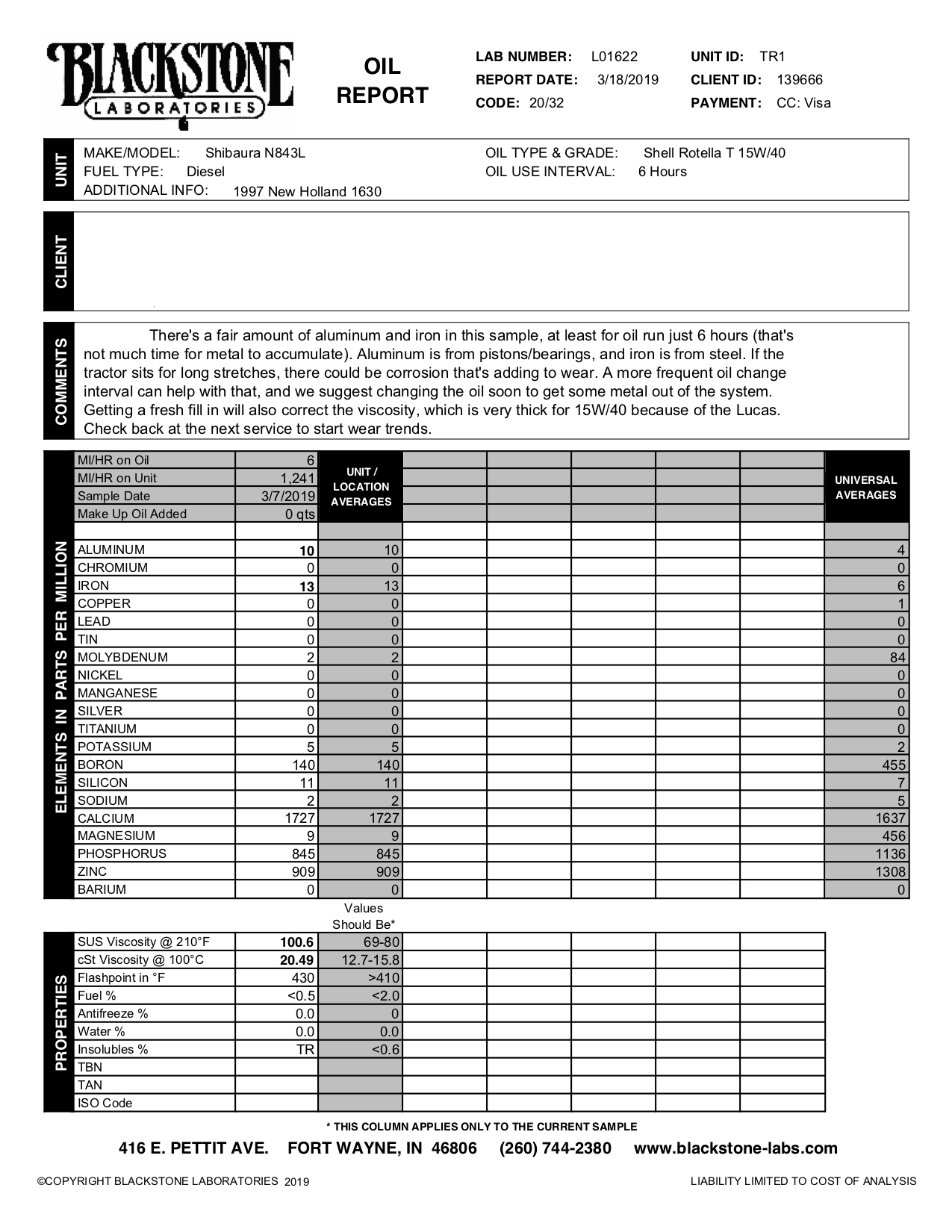

I’ve ordered an oil analysis kit from Blackstone. The machine has only about 6 hours on it since the last oil change. We’ll see if it reveals anything of interest. If not, then I suppose we’ll just run it.

I received the results of the oil analysis today and have attached them... I called the lab to learn more since this is my first experience with an oil analysis. The person with whom I spoke suggested that the aluminum and iron numbers may be residual from the old oil which was in for an extended period of time, and the possibility of corrosion. There wasn't an hour reading on the old engine oil filter when I changed it, but there was a date/hour reading on the HST filter, which indicated the last service was 152 hours earlier, and then we know it sat for three or so years. There's no way of knowing if the engine oil was changed at the same time. The Blackstone rep. also said that we'd likely see chromium if there was a ring issue, and copper and lead if a bearing issue.
Thoughts on the results and next steps?
   / Weaning NH 1630 Shibaura engine off of ether #26
That is your baseline!
Now....just wait for another 100 hours, and test again.

I wanted to provide an update to this. I ended up taking the machine to an independent farm repair/diesel shop in August. They removed the head to get a good look at the top end of the engine. It was pristine other than the valves having some rust/pitting from sitting. They cleaned up the valves, properly adjusted them, and installed a new head gasket. The machine sounds better. We've put about 40 hours on it since this was done and it's been fine.
