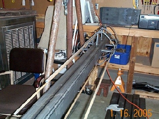

After all of the poles are in, I intend to dig a trench between the poles, put up forms and pour a slab. The rest of the post holes will be filled with concrete when the slab is poured.
RE tamping with dirt - I am bypassing the concern of rotting posts by using steel posts. 3.5 x 3.5 x 3/16" A500 steel tubing. I built a steel and rebar cage at the bottom of the poles which will then be tied in with the rebar in the slab.
Attached is a picture of the bottom of one of the poles.
Mark
