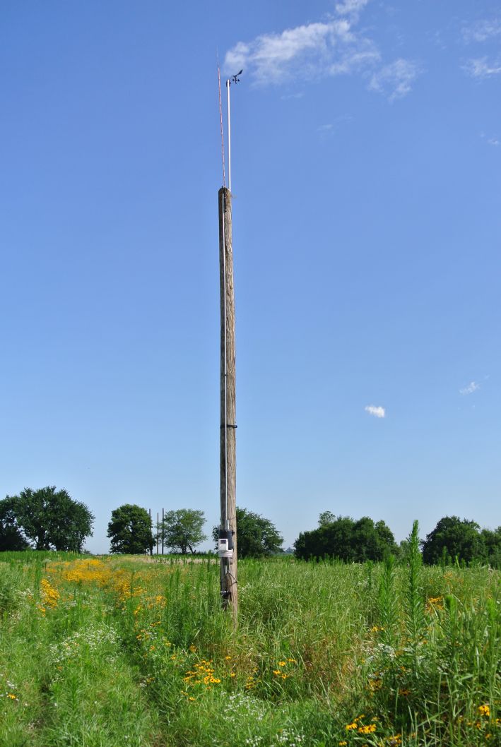

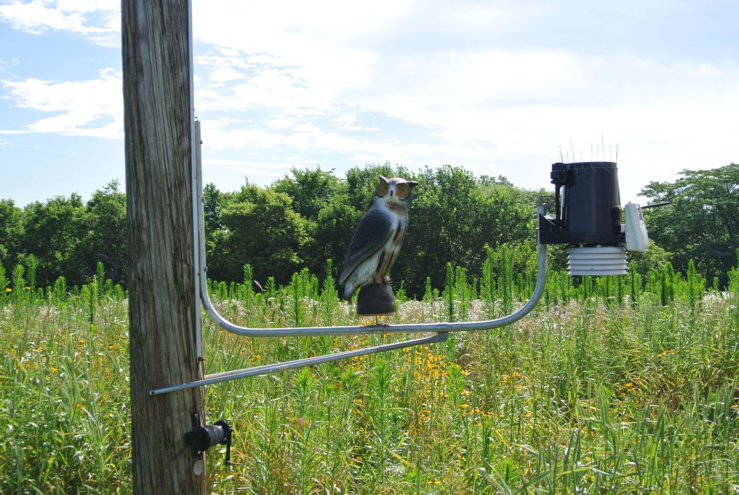

We have Davis Vantage Pro2 little more than 2 years. The anemometer broke some time after warranty expired but Davis shipped us test switch and when proved that the electronics was OK shipped new anemometer for free with only few questions asked and wanted the old bak. The new anemometer was somewhat different. It almost felt like the original had an issue they knew about.
The humidity measurement as reported to the web was wrong for some time due to incorrect setting in the little box that talks to the internet. Once I found the error I fixed the setting.
I had constant problem with birds pooping in the rain gage. To prevent that I installed stainless steel spike crown on the rim of the rain collector and also bought a fake owl that sits near the PWS.
The anemometer was located about 6ft high for over a year and last summer I finally moved the station farther away from the obstacles (300 ft away from the closest one) and placed the anemometer 30.8 ft high.
I also found that the temperature was affected by the proximity of the station to the wooden pole it was attached to. So it si now mounted on a cantilever about 3 ft long.
The flowers behind the PWS is prairie restoration project in progress.

Davis changed the anemometers from a reed switch to hall effect recently (within the last couple years I think). The HE switch is much more reliable.
I havent had issues with birds on mine but on this years(?) revision to the rain gauge, they added some bird spikes like you did and improved the screen inside. I was having issues with the flat screen in mine letting pine needles through so Im glad to see they addressed the issue, but I installed some fine screen in mine to stop the needles and so far so good.
