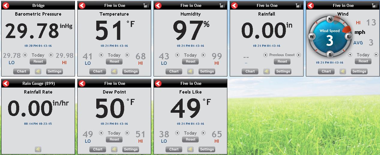

FWIW, the 1001 I have was child's play to set up.
Stick in the rechargeable batteries that came with and peel the protective sticker off of the built in solar panel.
Mount it on a pole somewhere in WiFi range and level it using at the built in bubble level and aligning it pointing it north (I used an Army compass and my iPhone's built in compass).
Go to underground at sign up for a weather station and get a call sign and password.
Enter the call sign and password into the monitor, as well as your longitude and latitude.
Done.
