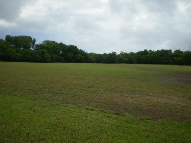

I Set My Brush hog to As Low & Level As I can & Kind of of Scalp it Without Allowing it to Dig in Then Cross cut it every 3 days or so . This was a Plowed , Planted then Cut alfalfa Field , About 8 or so Acres . That upto a couple of weeks ago I just Kept Rough Cut with the BH .
Now Its pretty Nice & Level & Thanks to the Rains last nite Its Still nice & Green overall . I,m Planning on Overseeding it with Fescue today After it Drys a bit More & Hopefully in 2 or 3 weeks it will Be in Great shape & Ready for a cut with the finish Mower .
I,ve Done this Before in Other Areas & it Worked Quite Well . The Main Thing is Getting it set to Where It Wont Dig in on the Front sides . I,d say with Just an Acre of Ground to Prep . You wouldn,t Have any Problem Making the Deadline Unless it Rains Everyday .
Ours Is Fairlly sandy Soil though & No rocks or Anything. But It Was Pretty Rough Just weeks ago . The Pic Aint Great But Gives You an Idea , No Its No Golf Coarse But soon will look Much Better , The Bare Spots Torwards the Bottom of the Pic & to the Right Are Ther For Drainage to a Small pond Project I,ve been Working on The Last few Months . Best Of Luck. Bob

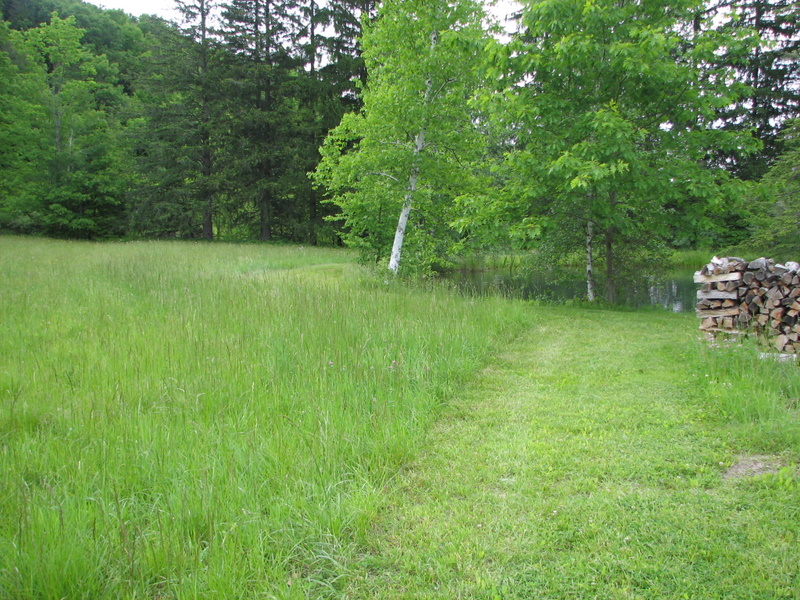

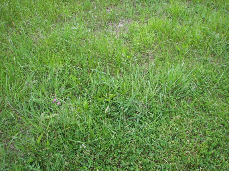

Hey, thanks for all the suggestions! I don't think I have time to grow anything, but I guess I'm going to brush hog it, then mow with the cub a few times and hope for the best. The roller idea is possible, as a friend has a small asphalt roller I could probably use.
Everyone who said the guests won't notice is probably right. If the bar budget is sufficient! The wedding is for an "adopted" daughter whose folks couldn't take care of this, and other things over the years.
I've attached a couple of pix of the field. Again, thanks for the replies
