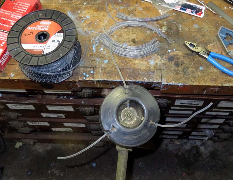

Seems Oregon may have discontinued them but Echo has them.
A couple of notes, if you use .155 string, you can't switch to other sizes. The cams seem to take the shape of whatever particular size.
These take power and won't work will with lower HP machines. For the same reason, you can't increase your string lenghts. We pre-cut ours to about 6" and if someone adds longer ones, it bogs the machine down and its slower speed doesn't cut worth a hoot.

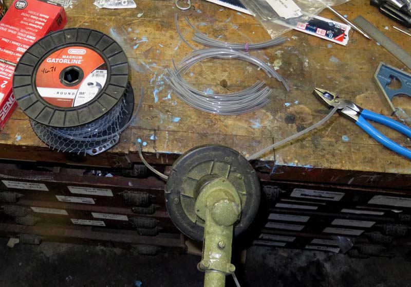

Mark, We've been running these heads for around 8 years now and yet to see a failure of one. We did try other of types and styles of heads and they all ended up in the recycle bin. Seems we might have 4 or 5 of these Echo heads in use today. We do run them right against the ground but since they are round shaped and made from HDPE plastic, doing that has no effect. The biggest grief we have is when operators install new string and don't leave enough sticking through to the inside of the head. Then when there string breaks off, you have nothing to grab on and pull the remaining string out. Needing to get the stud out is a bad day :).

For anyone who might care. Here is 2 photos of the Echo .155 string head, roll of string and some already cut to lengths. The length is 8".
For knocking the weeds and the young tree's down. This is how we do it.
