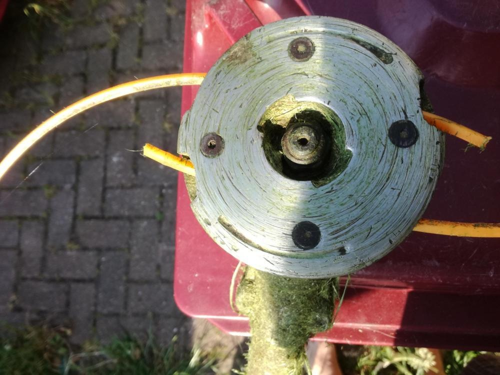

I'm curious about this timmer head:
"Oregon Jet Fit" (manufacturer link).
According to a couple forum posts I saw the orientation of the lines going into the header reduces breakage at that point, though to be honest that's not usually how I lose my lines. I kinda like how the end of the twine sticks out and should be easier to yank since the center of the echo head fills up with grass and dirt, though hypothetically having the little end out there in the air could incur extra drag though the velocity isn't that high close in.
There's a 2-line version and a also a 4-line version; the 2-line version has two aluminum disks which have the two lines going through them like this pic, and the 4-line has three disks with the other two lines going through perpendicular to the other two.
A post I read mentioned someone trying a knock-off from ebay for $25+tax/ship so I went looking and sure enough that knock-off is on aliexpress because most likely Oregon has the chinese build them so that company is also selling direct. I ordered two 2-line heads for $23 including shipping... previous experience says they could get here in a few days or a few weeks.
