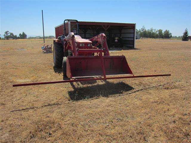

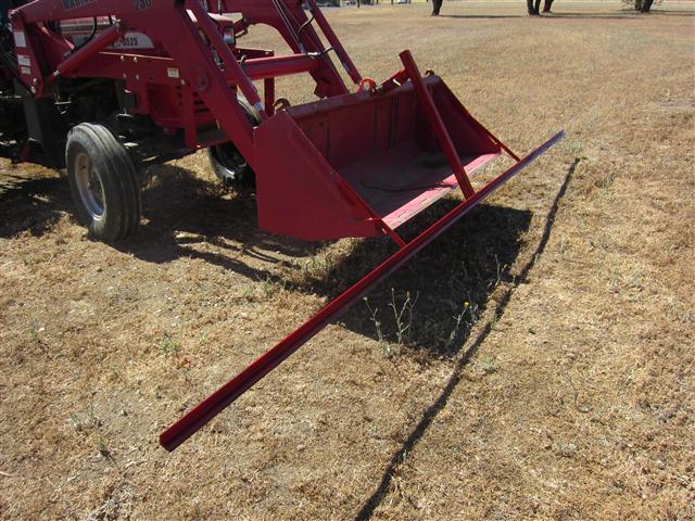

Last Spring I bought three 5-ft wick wipers ($109 each) from Ag Supply and lashed them to the FEL for a test run (41% Roundup, 2-1 dilution) on my 6 acre hayfield that had a good crop of yellow star thistle going.

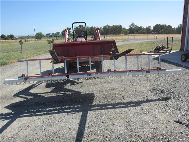

It worked fine. Killed off the weeds in a few weeks. Decided to make a better mounting rig for the wipers
You have to be sure to thoroughly clean the wicks and the PVC reservoirs or else the wicks will clog up (especially with Roundup which is sticky stuff since it includes a surfacant mixed in to keep it from running off the weeds).

How do you rinse the roundup out of the wicks? Do you simply run water in afterwards and let it drip onto the ground or do you disassemble everything to clean up?
Do you drive that setup forward or backward? If forward, does the roundup transfer onto the tires and then kill grass when the tires roll and touch the ground in other spots? If backwards, the tires are going to knock down the weeds so the wicks in those spots won't get wiped dry by the weeds. Then do the wicks drip in those spots where the tires knock the weeds down?

Rinsing--I used a garden hose to wash the wicks thoroughly. Then filled the PVC reservoir with water and let it drain out of the wicks. Kept this up for 8 hours or so.
I drove forward for this checkout run since it was easier to attach the wiper rig to the FEL and to see the action of the wicks as I drove through the weeds. If I were treating tall weeds in a hay crop, I'd change the rig to attach to the 3pt hitch--no big deal.
