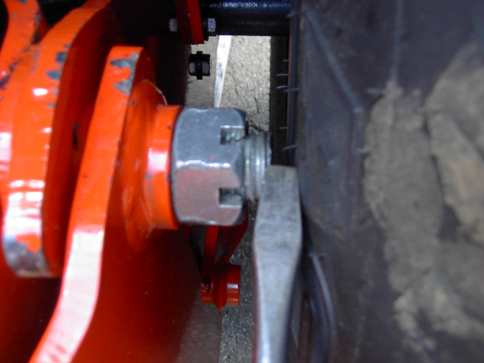

hmm, not surprised about the rubbing - there isn't much clearance between those bolts and the tires with r4s. I think spacers would be a good thing for stability in any case - I'll probably get them myself at some point.

Charles, sorry about those fittings....... honest, i just used a plain old wrench to tighten them ;) ! I never really paid any attention to the knives, but a sharpening and setting the knife-to-anvil clearance can only improve things.
Vic, thanks for the advice. I'll be sure to check the bolts in the axle housing occaisinally. One of our members here just broke one on his woods hoe on a B7800.

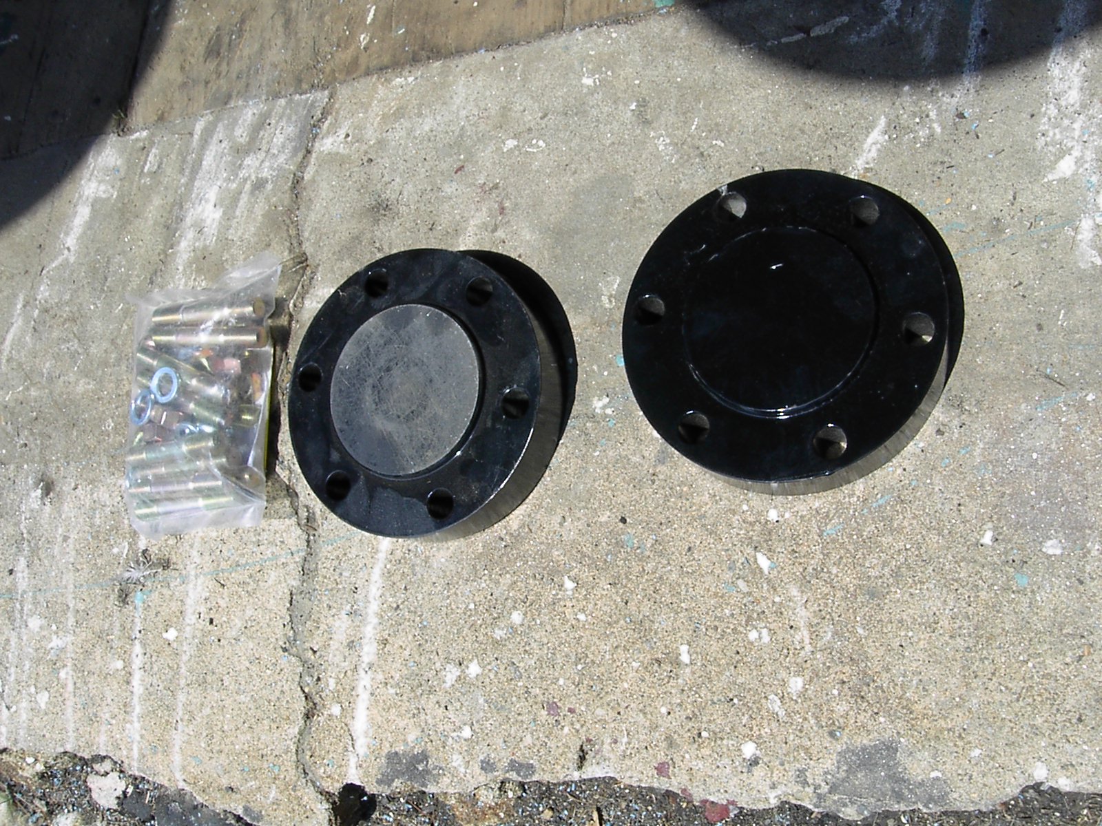

I decided today to fix my mounting pin to tire rubbing issue. My local dealer actually had a set of Kubota wheel spacers in stock. Not sure whats up, but they charged me $34 OVER list for them...... maybe they gave me too good of a deal on the subframe ??
Kit comes with a hefty 1.5 inch billet steel spacer for each side, longer wheel studs, and nuts and lock washers. They came black, so i squirted a couple quick coats of Kubota orange on them from a rattle can. You can see the ring around the tire where the pins were rubbing.

Very straightforward, removed the old bolts and studs..... installed the new ones. Baked the paint on the spacers @ 350 in the oven. Shhhhhhh !!! Don't tell Mrs. Ductape !! Tapped the spacers over the studs with a dead-blow hammer and re-installed the wheels.
One warning i need to add. Having owned several commercial trucks in the past, i used to mount all my wn tires. I thought i was well prepared to R & R my loaded rears...... boy was i wrong !! Lordy loaded tires are incredibly heavy ! Heed my advice and get yourself another set of hands if you are removing loaded tires :eek: .
My rubbing problem is now solved!

Cool spacers. How much further out do they move the wheels, the 1.5 inch? Do you find the tractor more stable at all?
I was thinking loaded tires might even need a forklift to deal with - now I know why those bolts were so tight - You are a strong guy ductape!

The spacers make the tractor 3 inches wider (total) in the rear, and i'd call the difference very noticable. It took a five foot bar on either side of the tire to get it on the axle. I'm guessing each wheel weighs 350 lbs.....:eek:
