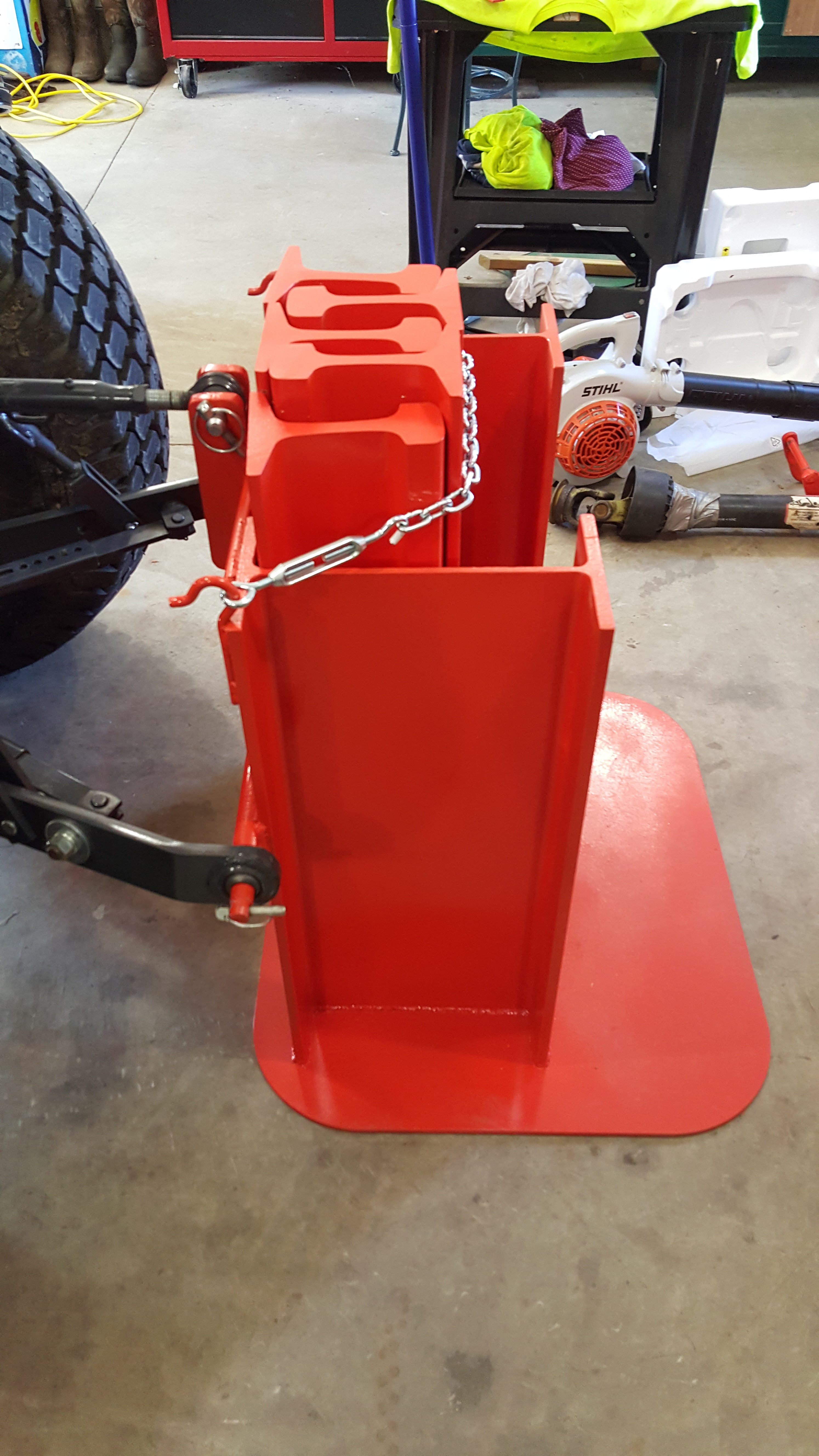

Well, Ive been working on my welding skills and I wanted to build my own box rather then buy one. The idea is the bottom half will be fill with concrete, about 800lbs . The top will house a couple chain saws, ax, hammer , oil and fuel. It turned out pretty good just not sure if I should add anything else before I sand and paint. The inside will have a wood floor and will be sprayed with bed line to protect the blades on my saw's. I'm hoping to paint it red if I can find the perfect match for Mahindra. Special Thanks to Paul Short for the inspiration, I really enjoyed challenging myself.

Thanks Paul ,I'm hoping to paint primer this weekend or maybe add a few more things to it. Keep the videos coming and go check out a mahindra so I can get some ideas. Glad you made it through the storm. I'll get up there one day
Do not use regular "paint" on that fantastic work!
Rust will find you readily if you do use "paint"!
Use TWO PART marine epoxy paint!
Both primer, and finish, should be marine TWO PART epoxy paint!
Forget about the Mahindra match!
Use TWO PART marine epoxy paint!!!

Not bad advise if you want the best... Shell Oil and others demand that on the offshore rigs. I think it is three coats. That said, I would probably just clean and surface prep real well (very important) and prime the same day before the metal has a chance to oxidize much. I like matching the OEM paint so I would rattle can spray.
