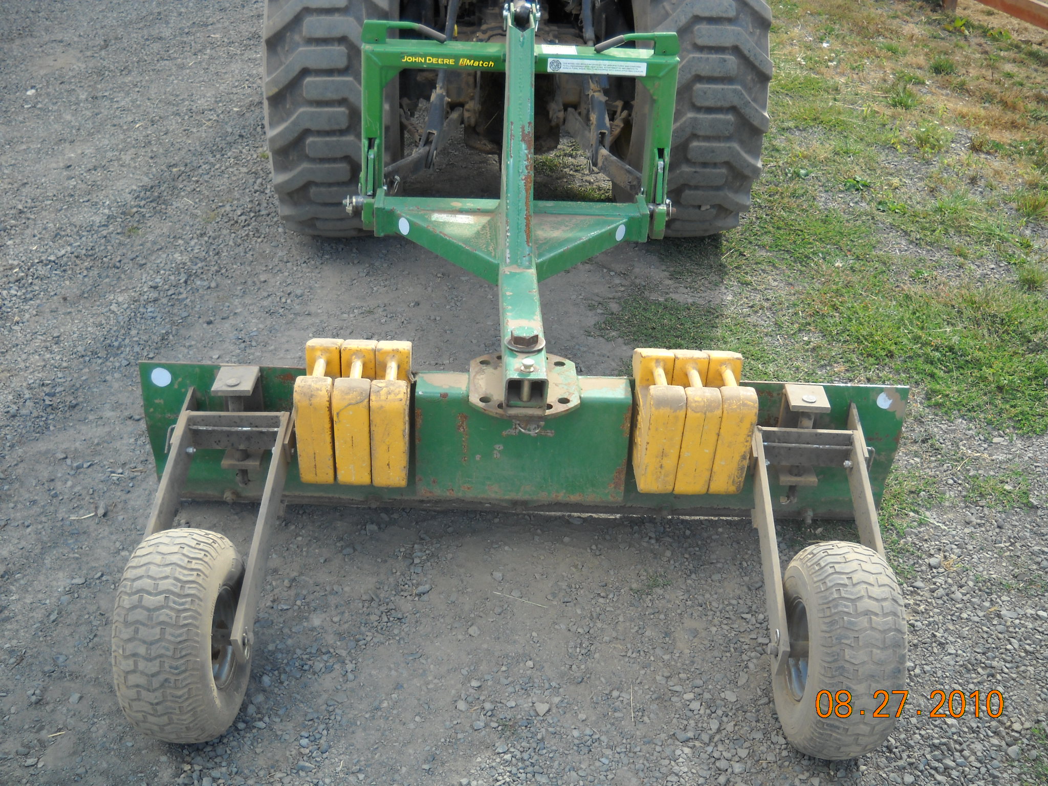

If so, you can hang several weights on it for ballast. I hang 6 40 pound Deere weights on my rear blade for ballast and since that extra weight hangs off the back so far, it helps weigh the back down better than weight closer up. :confused2:
