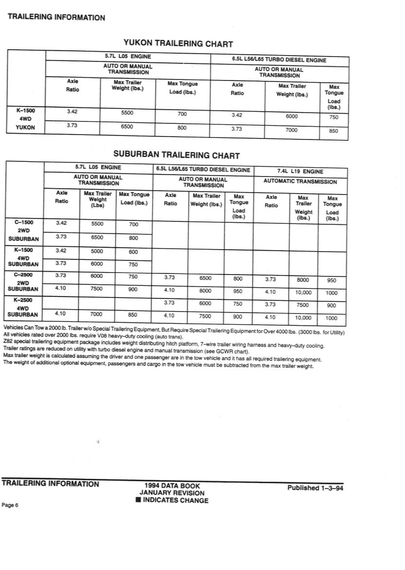

Moss,
I had a chance to stop by the dealer that has information back to 1990. I was thinking that you had a 94 so I am 1 year off. Although the numbers are the same as what my 90 Blazer was so they should be ok.
Please read the bottom notes on the attached sheet. The codes that are listed there should be in the glove box on the build tag.
To find which axle ratio that you have there will be either of the following codes:
GU6 = 3.42 axle ratio or
GT4 = 3.73 (I don't think that these have changed since 93)
While there also check for G80 which is the Eaton Automatic Locking Differential.
