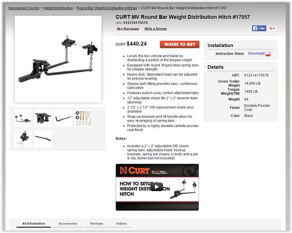

Called local RV dealership to check prices. The salesperson in parts described a "4-Point" hitch. Said it was good for most all travel trailers. Price for hitch installed...$1200.00.
I think the one I am looking at, Curt Weight Distribution System - Round Bar - 14, lbs GTW, 1,4 lbs TW Curt Weight Distribution C1757 , on Etrailer.com will be more than what I would ever pull or put on the hitch. Is there ANY reason NOT to go with the heavy duty hitch versus the standard duty? Seems a no-brainer, but having never fooled with this type hitch want to make sure I am not overlooking anything. Watched the video on the website by the manufacturer and seems easy enough to set up....especially compared to the $1200.00 price given for the other installed. Curt 17057.PNG
Another option for +/- $500 Equal-i-Zer Weight Distribution Equalizer Hitch 14# - $485.89 Sway bar jacket pads and balls at the bottom of the page.

Seems the Equalizer is a good hitch, but for my once or twice a year use the Curt unit with hitch ball for less than $250 should do the trick and be rated for more than my intended use. Should last me a long time no more than will be used. Thanks for all suggestions and opinions.

Placed order online at etrailers.com and received hitch and ball in four days at my door step. No complaints on service. Was able to make time this evening to put it together and adjust for my trailer. Instructions straight forward enough and product seemed well made. Next and final step is to test with load on trailer to fine tune the chain adjustments for the spring bars. Thanks for comments and input.
