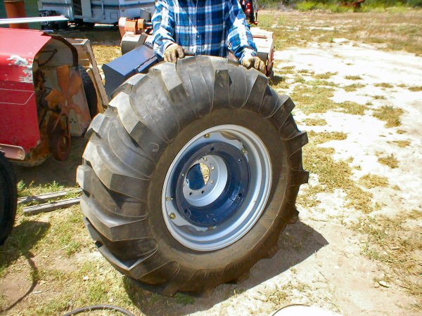

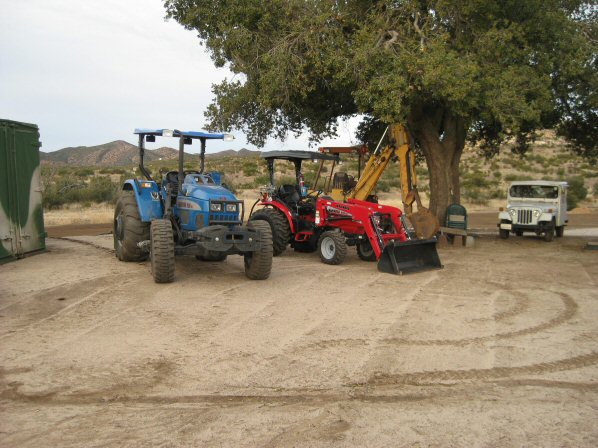

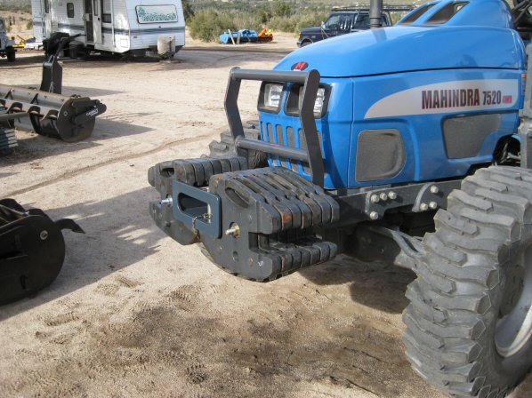

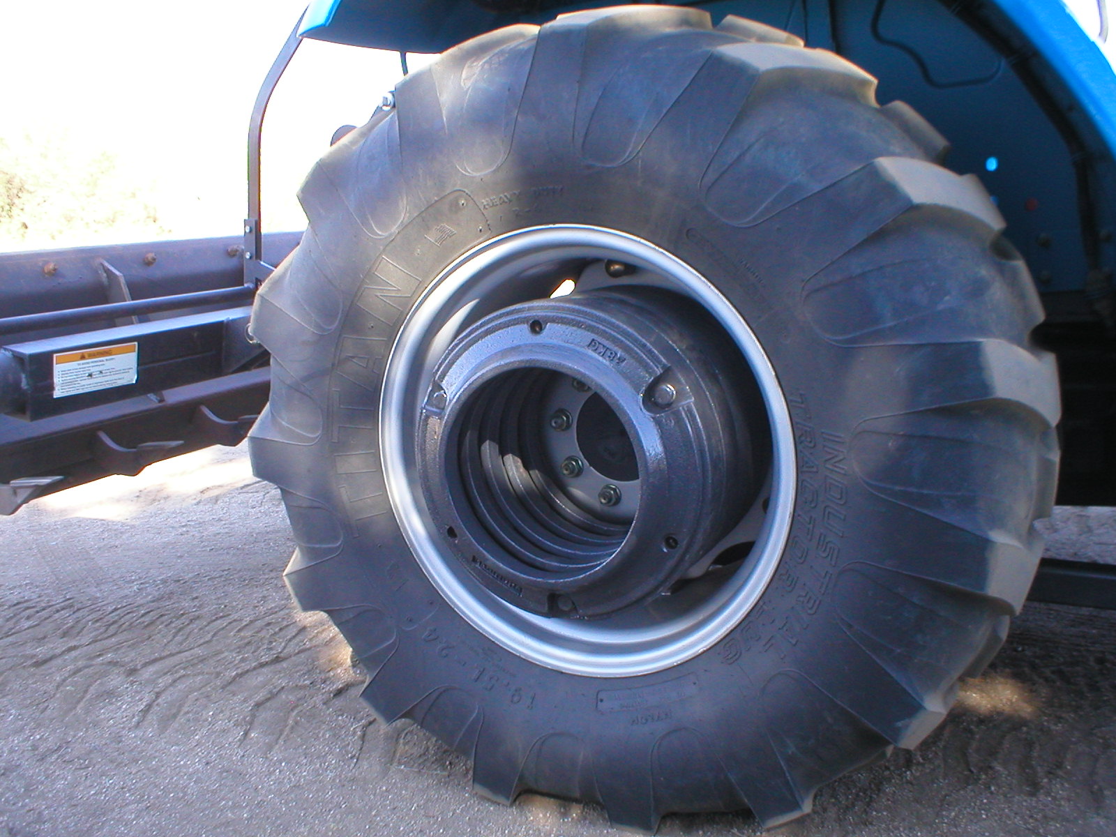

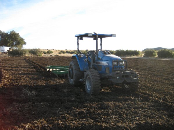

I have a 75HP Mahindra 7520. To get the max out of the tractor, I have it ballasted to the weight of 12,000lbs. All 4 of my tires are loaded, I doubled up on the front end weights and tripled up on the recommended rear wheel weights. I basically run out of power and traction at about the same time. I can always drop a gear for more power, but traction is lost and I wouldn't turn the ground properly even if I had the traction.
