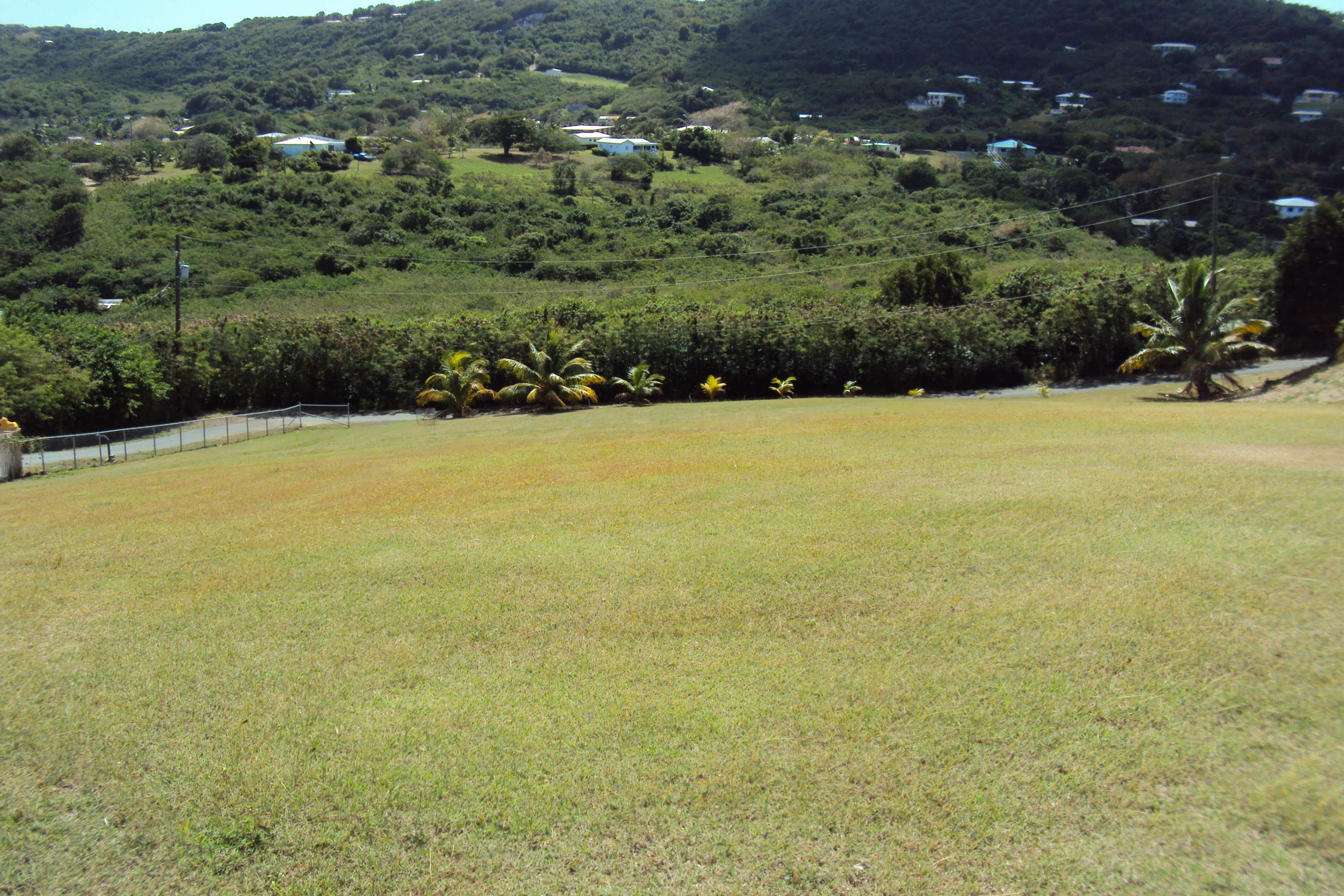

These are pics of some of the land I cut with my 318 or my 2720. Never had the need for ballast on dry or wet grass. Of course my loader is on the tractor but I don't yet have a ballast box. I ordered one for doing loader work
Wooden

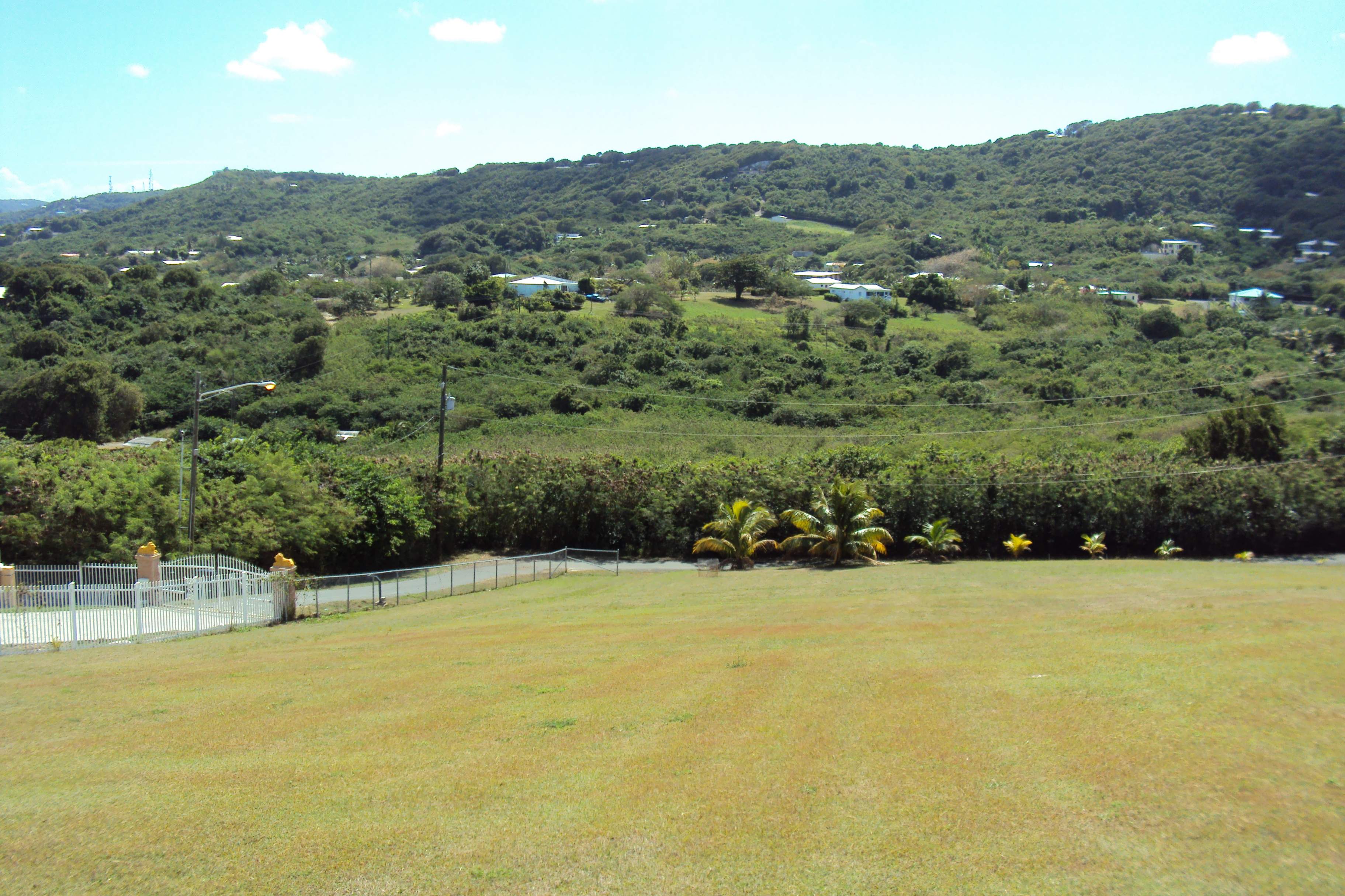

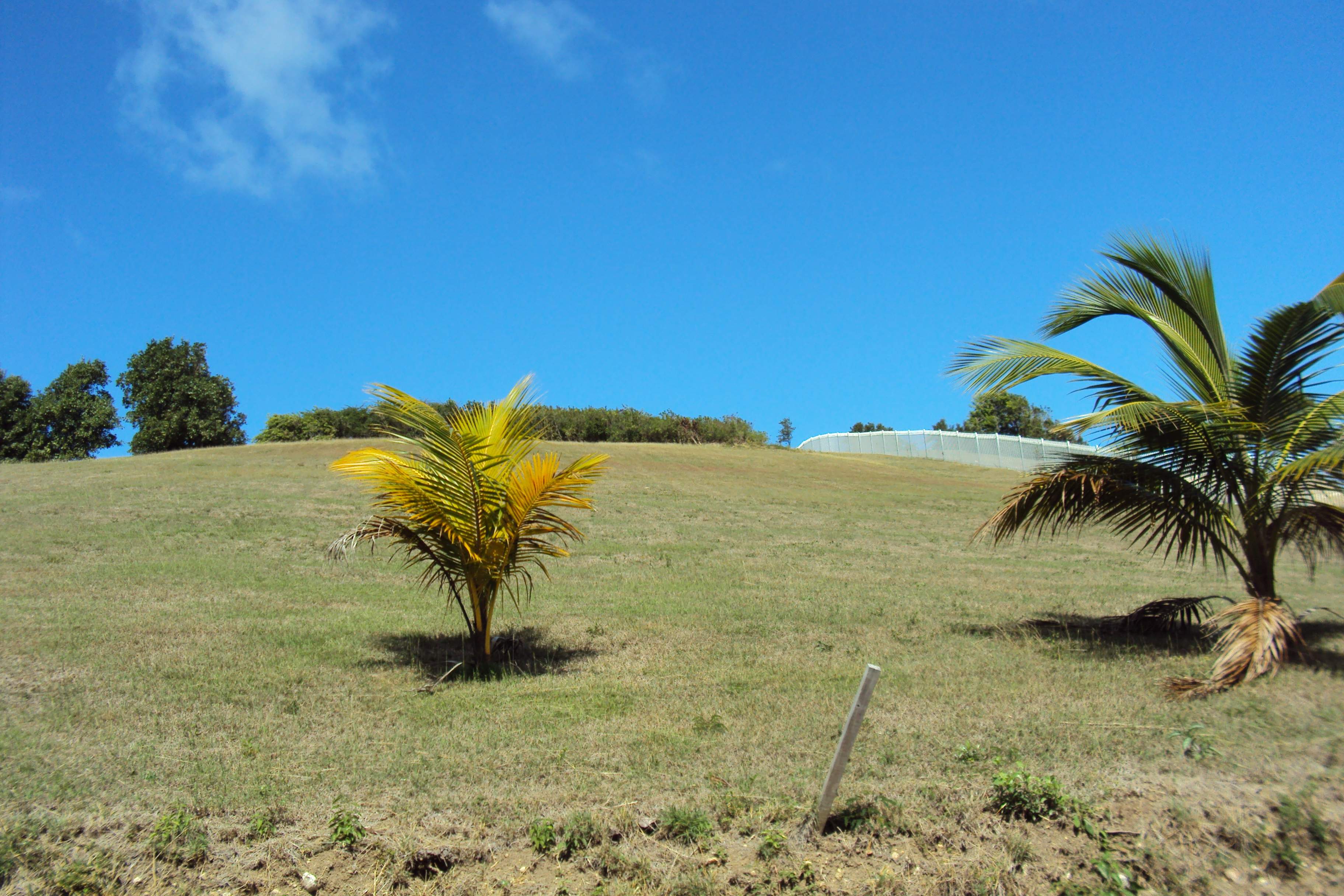

Hopefully this works this time!!
Good ! these are both looking up hill and down . Never had the need for ballast wet or dry. I an sure there will come a time on the wet where I may have trouble stopping going down hill, but I always keep my wheels turning so I can stear and keep the machine pointed in the right direction.
Wooden
