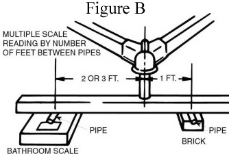

Perhaps some variation on the trailer tongue weight procedure?
