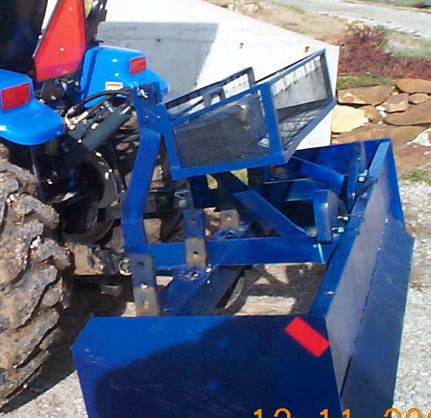

Used two front weights in rear of my box blade. The weight hook fits over the braces within the box blade. Welded a angle steel piece to hold the bottom of the weight. Bungy cords keep the weights tight against the back of the box.
Reason for the weights - more weight for the fel loads.

I added weight to my 4 footer. I found a slab of steel at the scrapyard a couple years ago. Added it to the very back wall , outside the box. It added about 320 pounds way back there where it does me the most good for front end loader work. Also makes the box blade more effective, especially if you have a bit of momentum, and it also pushes it into the ground better.
