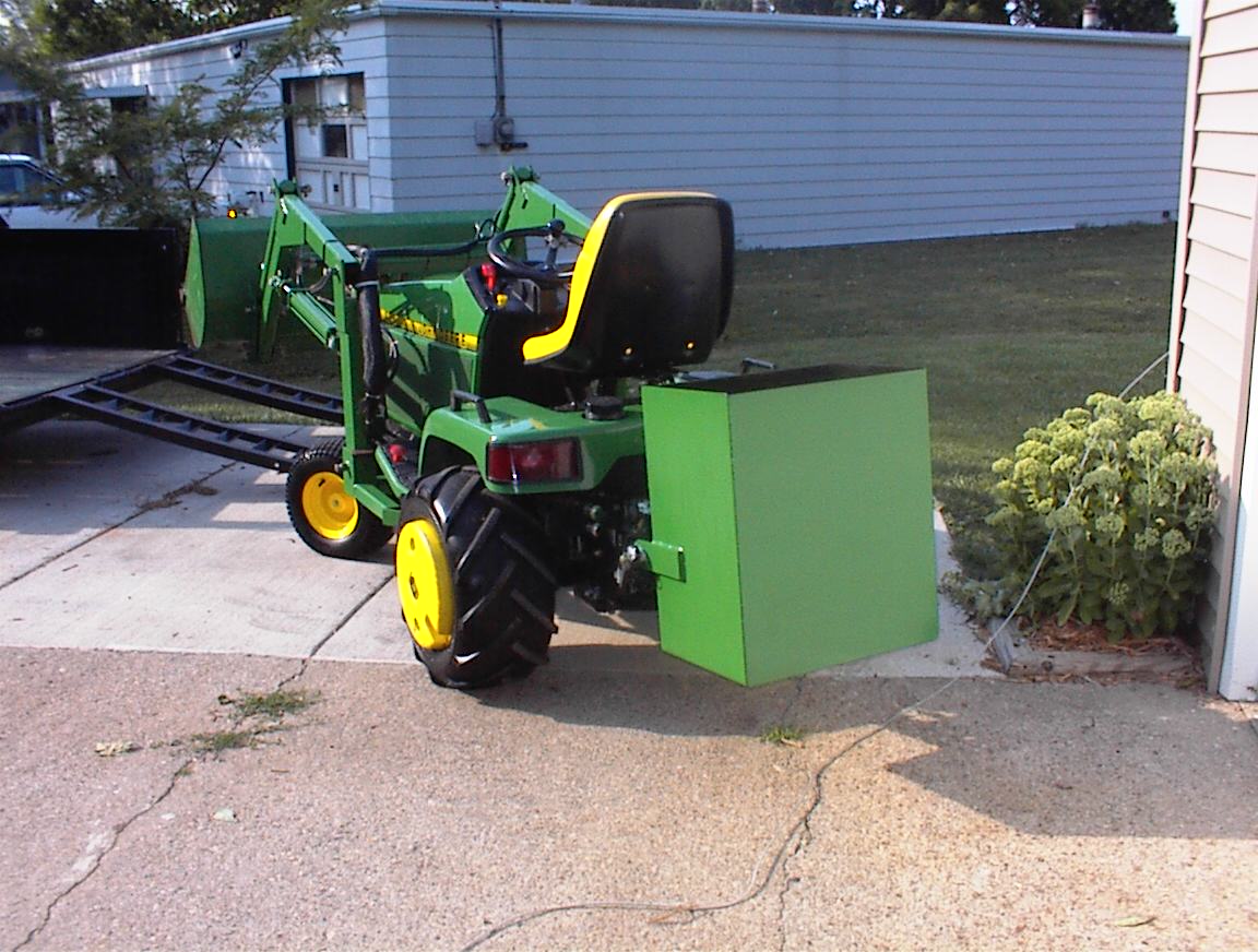

When I had my 425 I ran Windshield washer fluid in the tires (no tubes) and 50lbs wheel weights plus I used a ballast box that I put 5 - 80lb bags of quikrete into when running my home made loader. When I ran into a traction issue, it was because I was trying to perform some task that just was too darn big for the tractor or soil that truly required 4 wheel drive.
