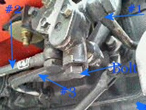

JJ, I'm glad you said that. There isnt a relief valve on the control valve, it must be somewhere else on the tractor. Any thoughts on where?
   / weird issue with fel valve #14
Yep, look under the right side foot rest for a hyd block. Some tractor relief are located on the hyd block.

Your hyd block may look similar to this.

Yeah I have a hydraulic block like that. I'll check on it too. The hydraulics have been worked on. I don't know when or by who but a bradco 511 was added. It has a t fitting that attaches it into the return line and you swap it's line onto the pb port at the loader valve (there's quick connects One for 3pt hitch, one for backhoe)

With no BH installed, your hyd path should be like this.
Pump to hyd blk, then to FEL, FEL OUT back to hyd blk PB to 3pt, then to tank.
All return hoses should go to tank unimpeded.
If BH installed, then the PB out of the hyd blk would go to the IN port of the BH, and the BH OUT hose would go to a return hose.
You probably would not use the 3pt with BH connected.
The bolt on the bottom of the hyd blk, is the tractor relief.
You might check the relief pressure.
