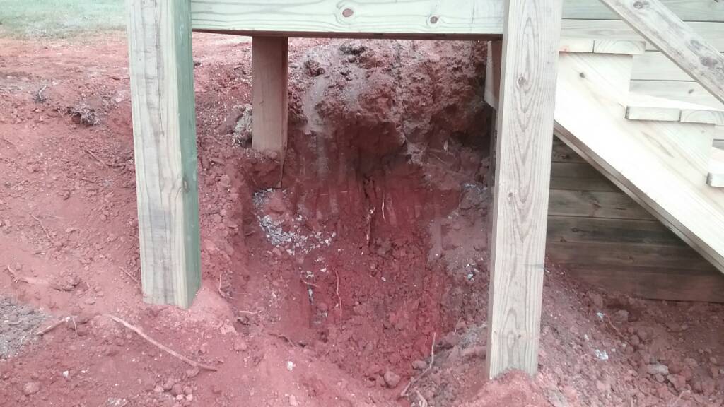

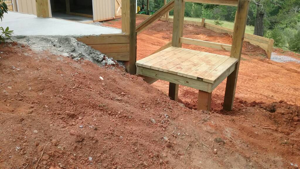

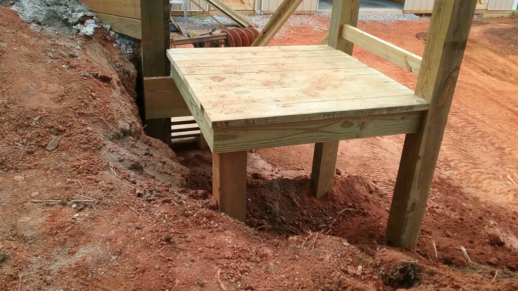

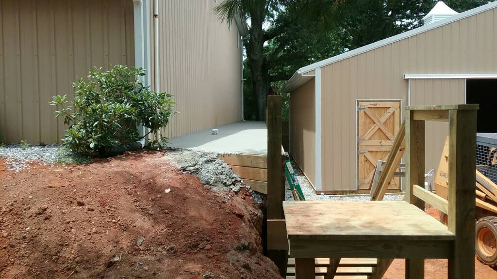

This is weird. I'm having a barn built, and to get to lower level I had pressure treated stairs put in with a 4x4ft landing at top (My idea). Two posts were augered in. One stair stringer is attached to a retaining wall. I told them I'll need to dig down then use scrap 2x6s treated on two sides so I can backfill it, walk over to deck.

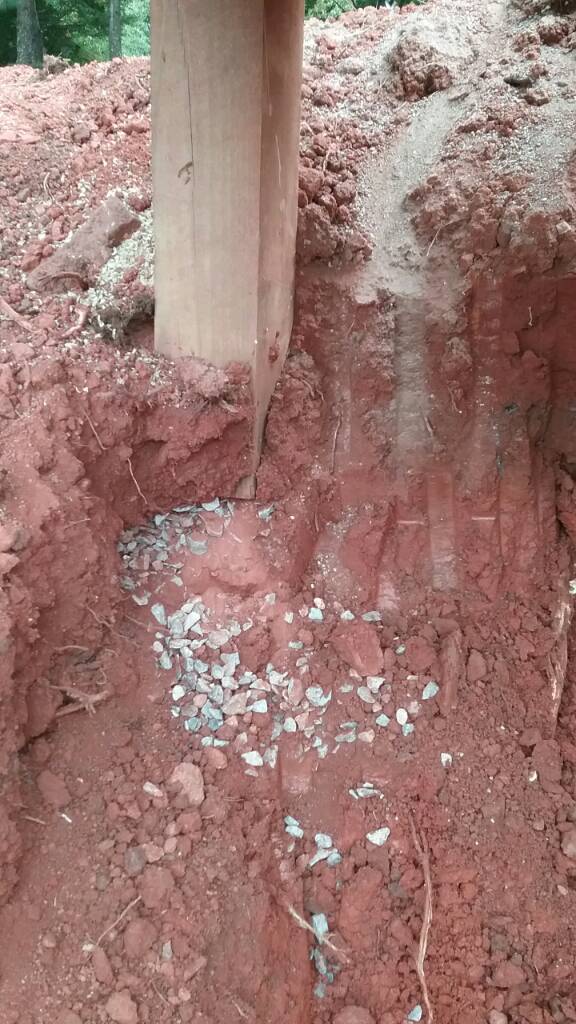

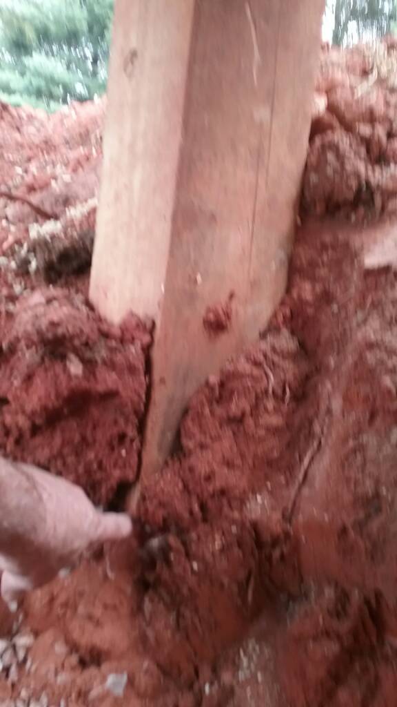

I just backhoed and raked it and the one post is 30" long sitting on dirt! Shouldn't it be augered in?
I haven't made final payment, and wonder what to do. Can I drill a hole beside it, attach post to it (parallel)? All along I've been helping, doing some of the work, but although it seems sturdy now, it can't be right. 20190716_134121.jpg20190716_172124.jpg20190716_172133.jpg20190716_172208.jpg20190716_172201.jpg20190716_172222.jpg

That 6x6 post is only 30" long though. I could fairly easily dig under it and fill that with concrete, or a block under it. Other posts were augered three feet down, posts set in concrete and tamped. This one is as you see a few inches underground because hill rolls off.

What's your definition of augered in? To me it looks like it was put in OK until it was dug out.
Technically it just needs to be sitting on undisturbed sub-soil below the frost line to be correct (and of course the footing area of the post bottom and the load capacity of the soil type must give enough support, which is likely the case for a stair landing).
   / Weird new stairs problem?!???
It wasn't dug out. It was dug beside it. The supervisor just left. We were able to poke a 4ft piece of rebar underneath until we hit solid ground. He agreed it wasn't right, I'm glad I spotted it now. We'll get it fixed.

I agree it needs to be replaced. You don't want 3 posts set below frost line, and one on only set inches deep. That shallow post will eventually heave and cause issues so I'm glad the builder is fixing it.
