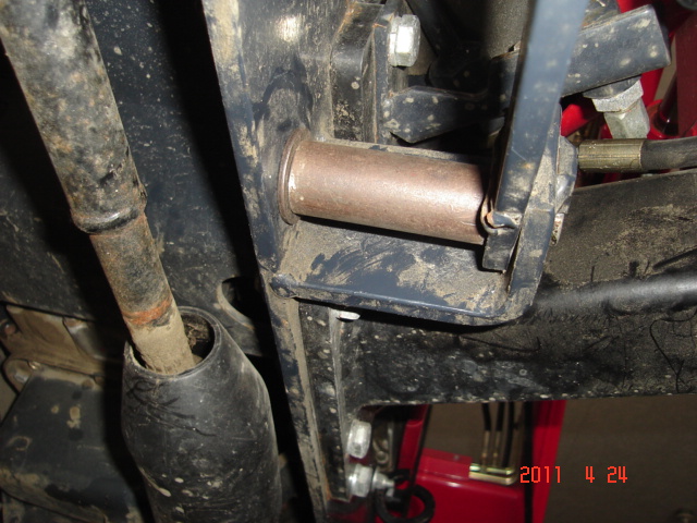

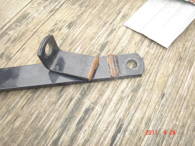

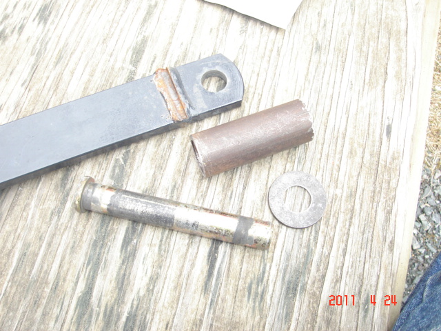

So far this summer I discovered two small issues. I bent the right-side lift arm leveling assembly (bent where the threads enter into the assembly)...I have no idea how I did this, but I was using the tiller as ballast while moving a lot of dirt w/ the FEL over some bumpy terrain (too lazy to take the tiller off since I was going to be using the tiller again) so I'm guessing it happened then. The check-chain was short enough that it wasn't banging the lift arms into the backhoe hook-up, so I'm a little puzzled...no more using the tiller as a ballast, I'll use the yard rake.
One of the welds on the flat steel bar that connects the left and right arms of the mower deck mounting assembly broke as well. Not sure exactly what it is called...but it is the dark gray removable bracket that attaches the front of the mower deck to the tractor frame.
Oh well, easy to fix and I have all winter to deal with it.

JohnnyB- same as mine on the mower deck? Here's what I did:
