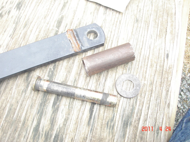

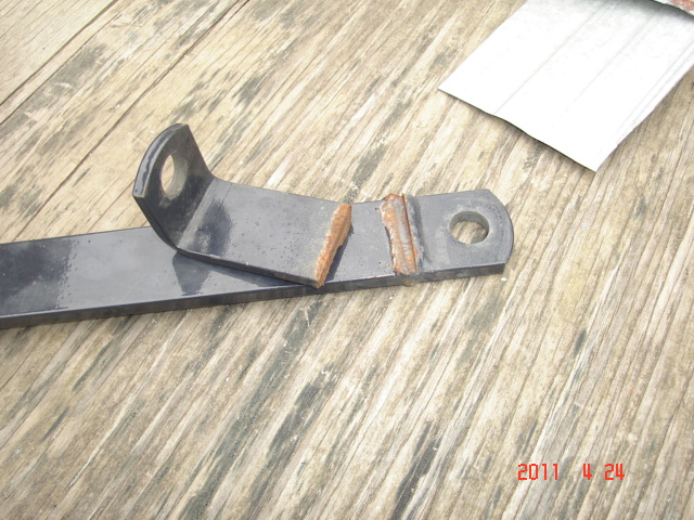

It is easy to see why it broke. They used the same welder that welded the pins on my LS seat suspension. Tack weld was so small you can barely see it. Same with that weld, very little throat in the fillet and only welded on one side at that. A good weld on it will fix it up.
   / Wel it's been a while since I tore something up...... #13
No, Wacky, I didn't weld it.

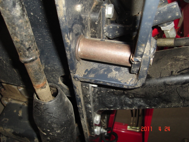

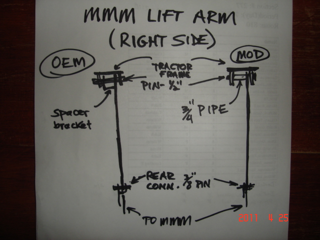

This was on both MMM lift arms, and as near as I can figure, that little angle piece is only there to keep the lift bar in better alignment to the attach points on both its ends; that is, to keep it toward the outside of the tractor where it attaches to the tractor frame.
All I did was put a piece of thick-wall steel tube with washers on both ends in as a spacer around the bolt there (pic 3) to maintain the positional alignment -- and left that little angle off altogether. I doubt my system will break off like the original design did.;)
