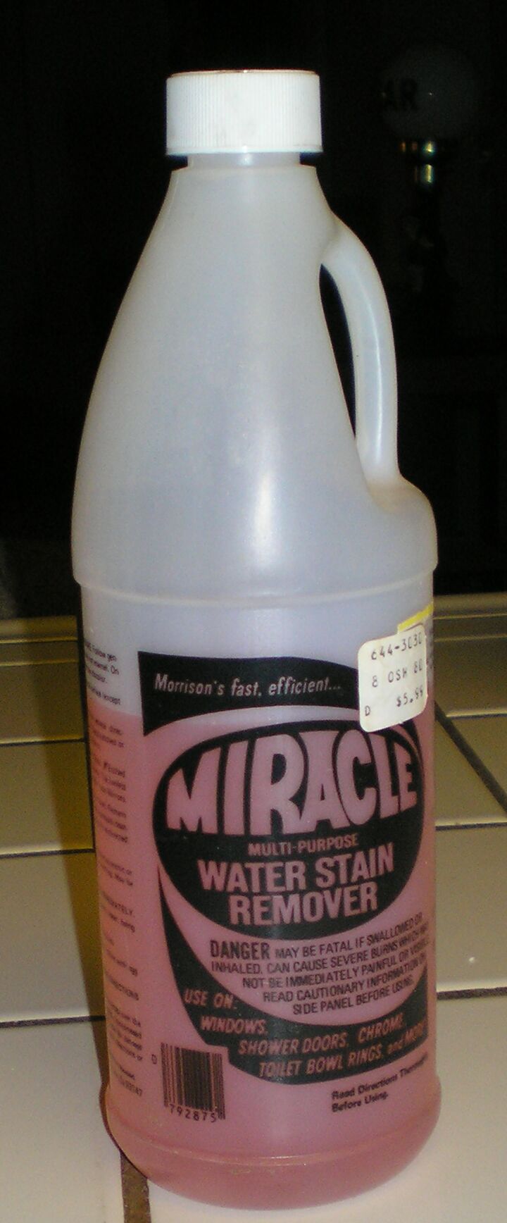

HomeBrew2 said:
Miracle Water Stan Remover (hydrofluoric acid ... another bad hombre) ... it etches so good, paint sticks like a bad girl on a rich dude.
Homebrew2,
I am going to call you on this one. I think you may have mis-read the label. I know what HF does, it penetrates the skin painlessly and then hours later dissolves your bones with excruciating agony. I know of no home use for HF. Industrial uses are for glass etching and anisotropic etching of silicon. As a pre-welding treatment...never heard of it.
If I am wrong, please point me to the correct info. I did a quick search on the name you gave and found no such product. But, I am not the best searcher.
jb

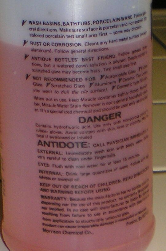

Yeh, I see what you mean. I can't find it in a search either. I admit, this bottle could be 10 years old. I bought it to remove, what had become, a solid sheet of calcium on my sliding glass door (sprinkler spray) ... didn't actually get around to that job till last year :eek:
Attached is a pic of the label, and one of fine print. There is enough resolution to read it all ... hopefully it gets posted as such.
I'm sure other stuff works. This is just what I had on hand and it really gnaws the galv well.
At what concentration and how much exposure causes the gruesome results you relate?
Looks like you can read! And were correct. I don't know the answer to your exposure Q, but From Wiki on hydrofluoric acid;
Safety
Symptoms of skin exposure to dilute HF are not felt immediately, but exposure of less than 10% of the body to it can be fatal, even with immediate medical treatment. Highly concentrated solutions may lead to acute hypocalcemia, followed by cardiac arrest and death, and will usually be fatal in as little as 2% body exposure (about the size of the sole of the foot). This substance is extremely toxic and has the capacity to kill upon exposure rather than simply damage skin and eyes. It should be handled with extreme care, beyond that given to hydrochloric, sulfuric, or other mineral acids.
Due to low dissociation constant, HF can penetrate tissues quickly like a small non-polar particle. Hydrofluoric acid which comes into direct contact with the fingers can severely damage or destroy the tissue underneath the nail without causing any damage to the nail itself. It is this ability to cause little harm to outer tissues but considerable harm to inner tissues which can produce dangerous delays in treatment of hydrofluoric acid exposure. Once the pain starts, it is out of proportion to the burns produced. Patients often describe the feeling as if they have struck their fingers with a hammer. HF that penetrates under the skin causes later development of painful ulcers, which heal slowly.
The highest concentration of HF in air that can be tolerated by a human for 1 minute is 100 mg/m3. This causes a definite sensation of pain on the skin, a definite sour taste, and some degree of eye and respiratory irritation. If the air contains 50 mg/m3, the sour taste is apparent and there is irritation of the eyes and nose, but no pain is sensed on the skin. The concentration of 26 mg/m3 can be tolerated for several minutes, but the sour taste becomes evident after a short time, and there is mild pain in the nose and eyes. The American Conference of Governmental Industrial Hygienists has adopted 2 mg/m3 as the threshold limit for hydrogen fluoride. This comes to about 3 ppm (parts per million). Inhalational exposure to concentrated HF for as little as 5 minutes is usually fatal, producing death within 2-10 hours.
Personally, I would trash that stuff ASAP. There are other safer chemicals that will do the same thing. It is probably a very dilute solution, but not stuff to be used lightly.
jb
