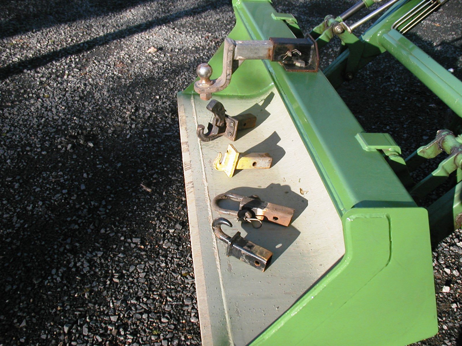

You could also bolt a 2 in receiver in the middle top.
Thank you,

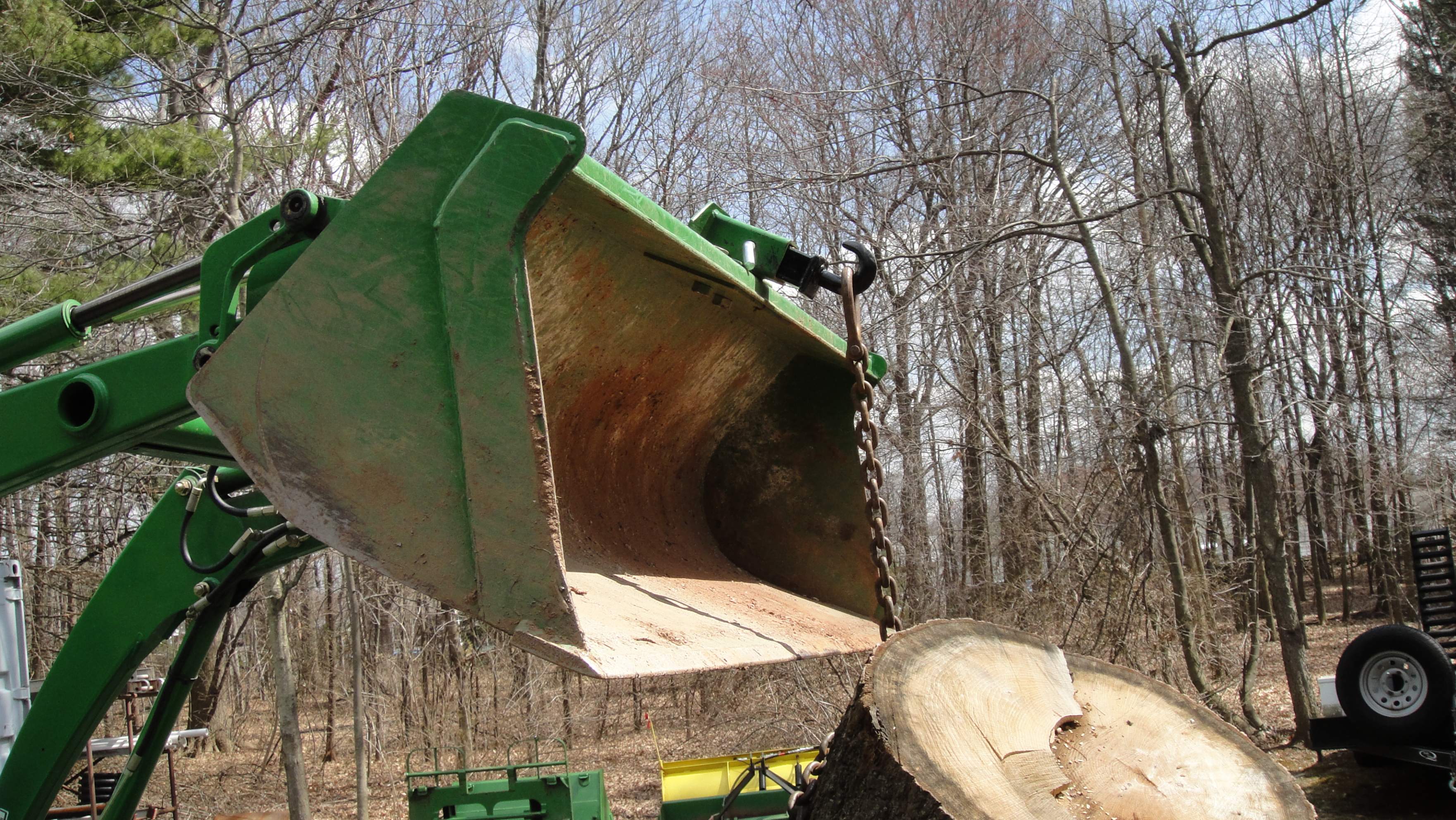

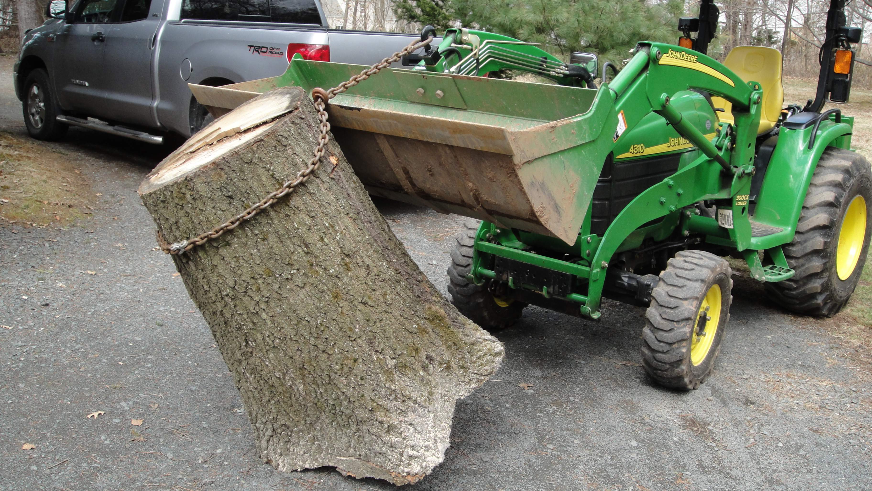

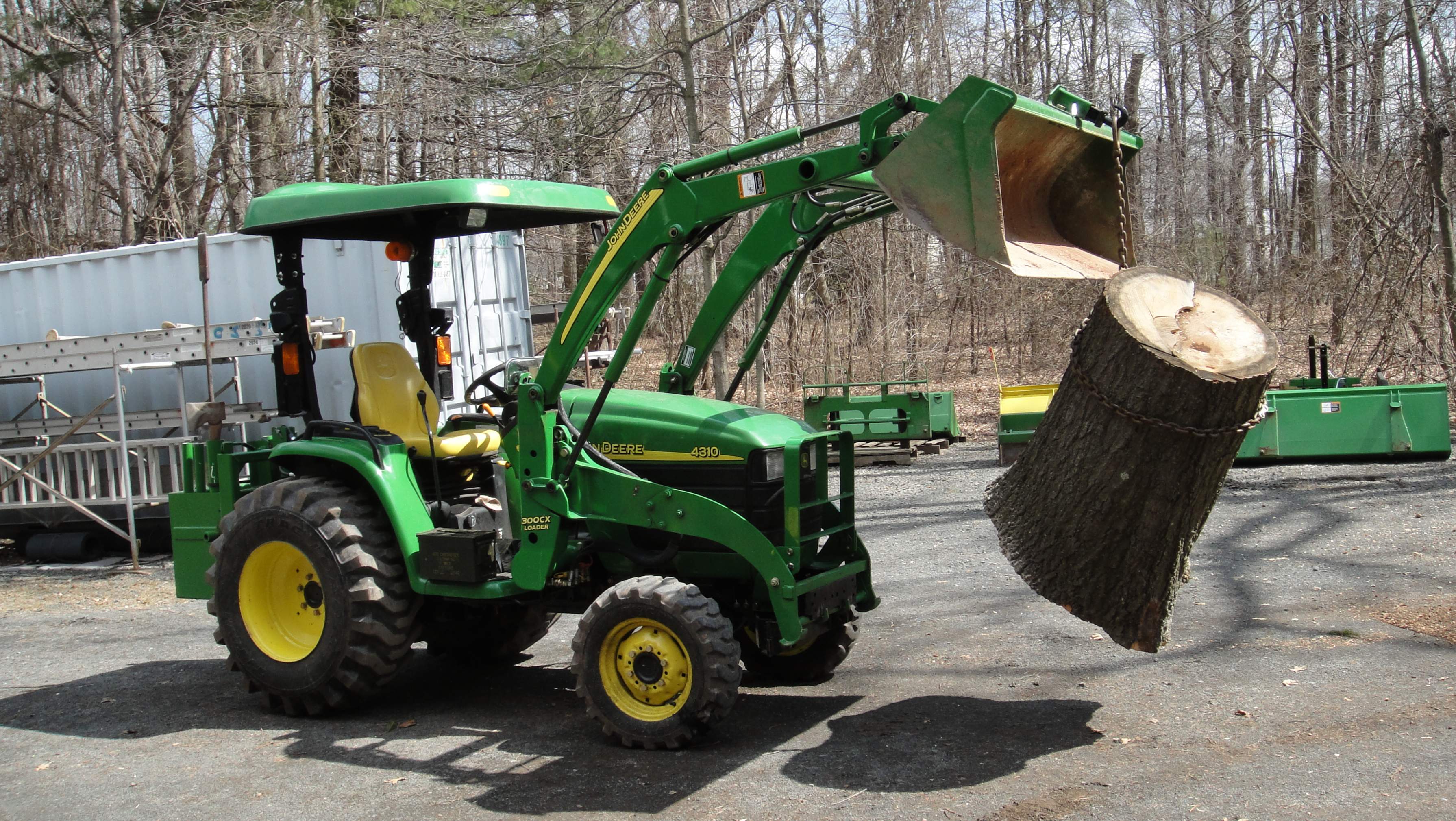

Every time hooks come, up I post pics my handy "Bucket Buddy"
I'll tell you these JD bucket tops are pretty well designed, double wall with a strategic bend makes it brutally strong.
This, from the other day, is a 40" dia (at the bottom) red oak log cut off the stump, don't know how heavy, but very heavy. Not even the slightest deflection in the top of the bucket. I only have a small plate under the tube and under the nuts, no extra reinforcement across the top of the bucket.
JB
