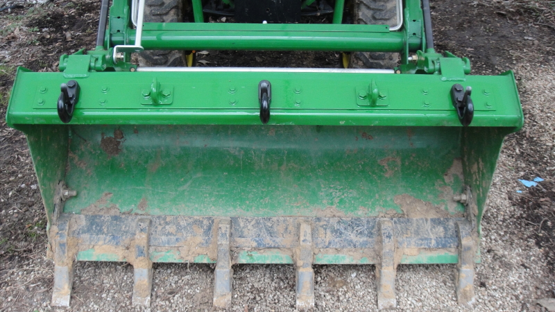

Have you seen these?
Bolt on Grab Hooks
I got mine a couple of weeks ago and used them for the first time today to pull over an 8 foot tall rotted stump. Thanks Kenny it's a great product.
attachment.php
