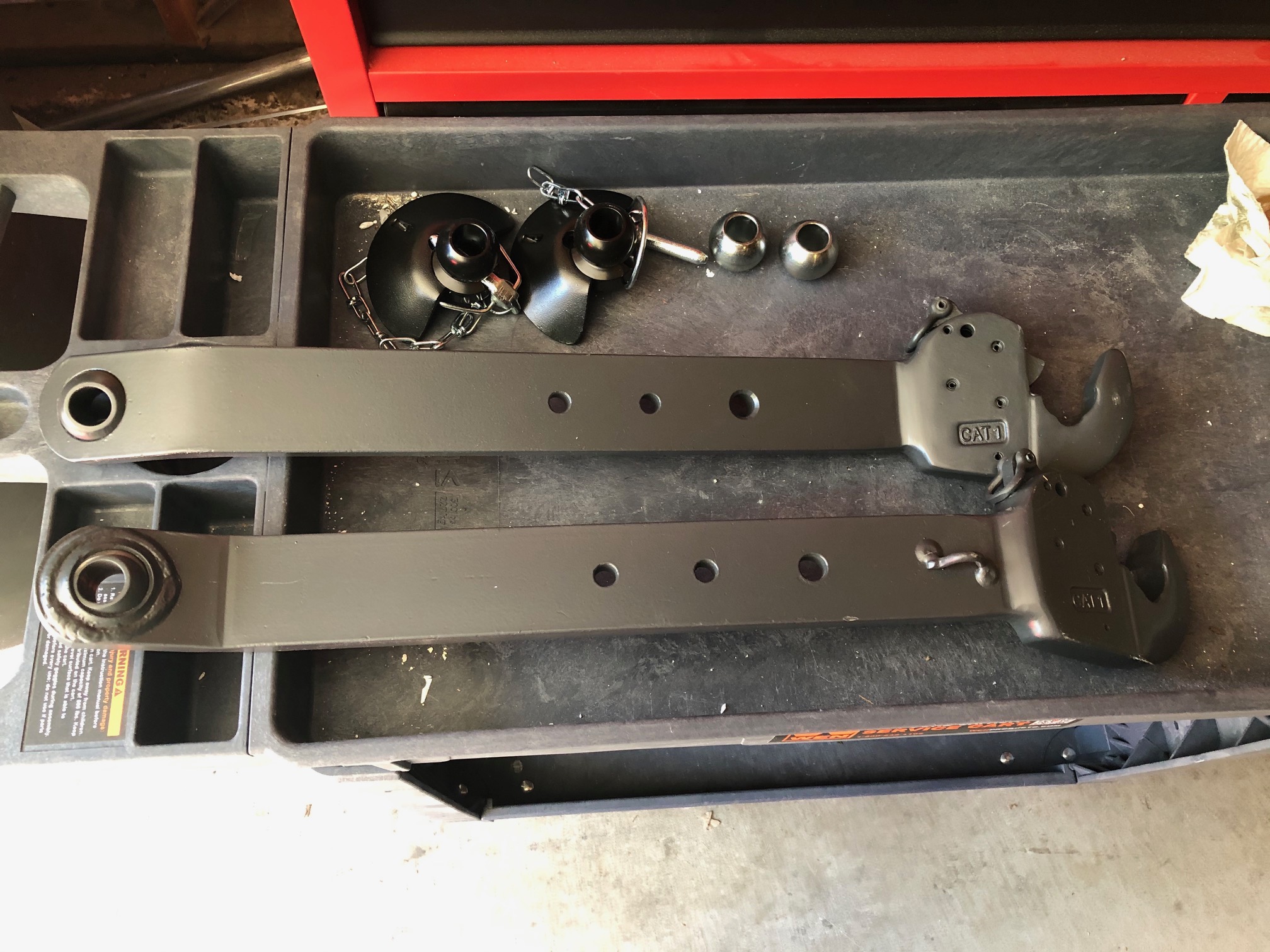

I decided to have Fit Rite Hydraulics modify my draft links with these hooks. Photo attached. I've done all my own welding since before I left home, but decided to give myself a treat and have Brian do it instead. They look great.
I have used a fixed quick hitch for quite a while, but it has some drawbacks. Now that Brian has the Cat 1 hooks (versus Cat 1/2) I made the change.

Nice work. Looks very nice.
Let us know how do you like them.
By the way, did you get enough balls for all the implements? Otherwise you will be constantly playing with your balls. :D

Never paid attention to the Euro system- how are the balls attached to your implements? The welding/grinding work almost looks too good for farm equipment! I've seen videos in the past of implements being exchanged using that system, and it looks very practical and efficient.
/ Weld On Euro Style Draft Hooks
I'll put up some photos of the installed arms with implements when I get back to the property in a week or so.

They look great... How long did it take to have them welded up?....
/ Weld On Euro Style Draft Hooks #9
Sent them to Fit Rite (southern CA) one week, got them the next (northern CA).
Nice.... fast turn around from a one man show.........:thumbsup: ... I might get a set...

As far as the implement balls I think I'm at about 6 or 8 pairs now and contemplating getting a few more.

I hope you love them as much as I love mine! If I had to do it over again on a standard L Kubota I would have gotten the Cat 1 hooks like yours. I have one implement I had to tweak a little to get clearance behind the hook.
