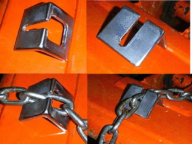

   / Weld or bolt on hooks on my bucket kubota l2800 #13
Here's a different twist on using angle iron chain hooks.
I haven't seen it done this way before. Unconventional perhaps. A little more work, a lot more stronger.
These are 2x2x1/4 HRA x 2.4 long. That's 5/16 chain in a .406 slot.
They aren't welded on yet because they look kind of puny on the 72" bucket.
I will make some up from 3" angle and see how proportional they look in my free time.

   / Weld or bolt on hooks on my bucket kubota l2800 #14
AntrimMan,
I really like the looks of those! Once you get the 3" ones made, please post a picture of them. Would you be interested in fabricating a set for me? I'd be happy to pay for the material/labor/shipping (within reason, of course).
That looks like a very simple, yet very strong design. If you decide not to use these that you already have made up, please let me know. They look like they'd work quite nicely on my 60" bucket.

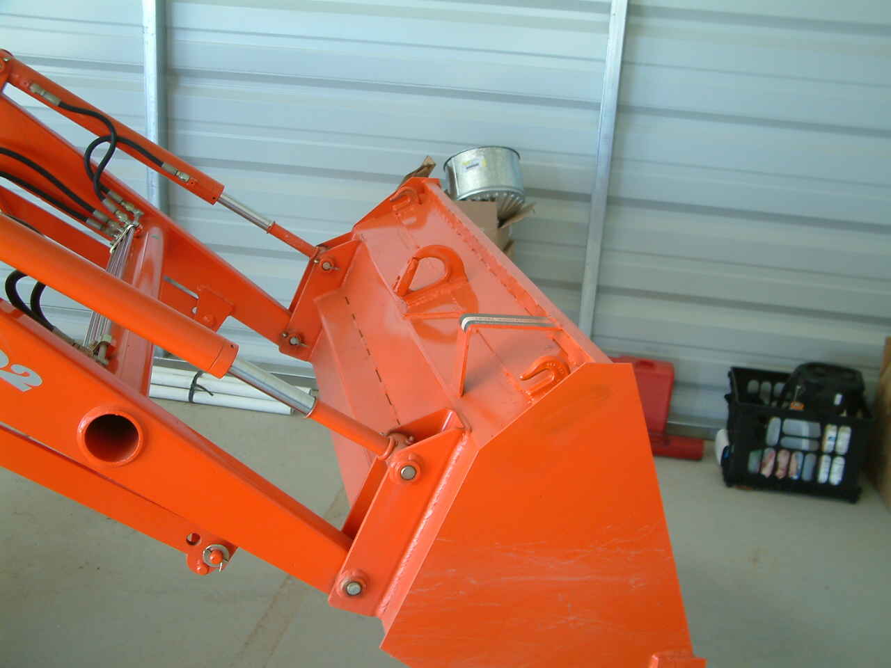

   / Weld or bolt on hooks on my bucket kubota l2800 #17
Here's what the chain hooks look like on my B7510HST with LA302 FEL. The dealer welded them on the bucket after reinforcing with steel plate. He also did the repaint job. No charge.
The outer hooks are 3/8" size from AW Direct.
web page
The slip hook in the middle is a Gunnebo-Johnson weld-on anchor hook also from AW Direct.
