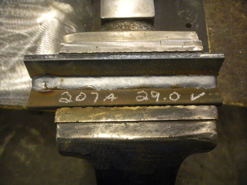

Now here is a hot Mig weld!:laughing: .035" Lincoln L-56 wire.

nice weld -- I cant do that ... yet . I hope to do that good before I die.
