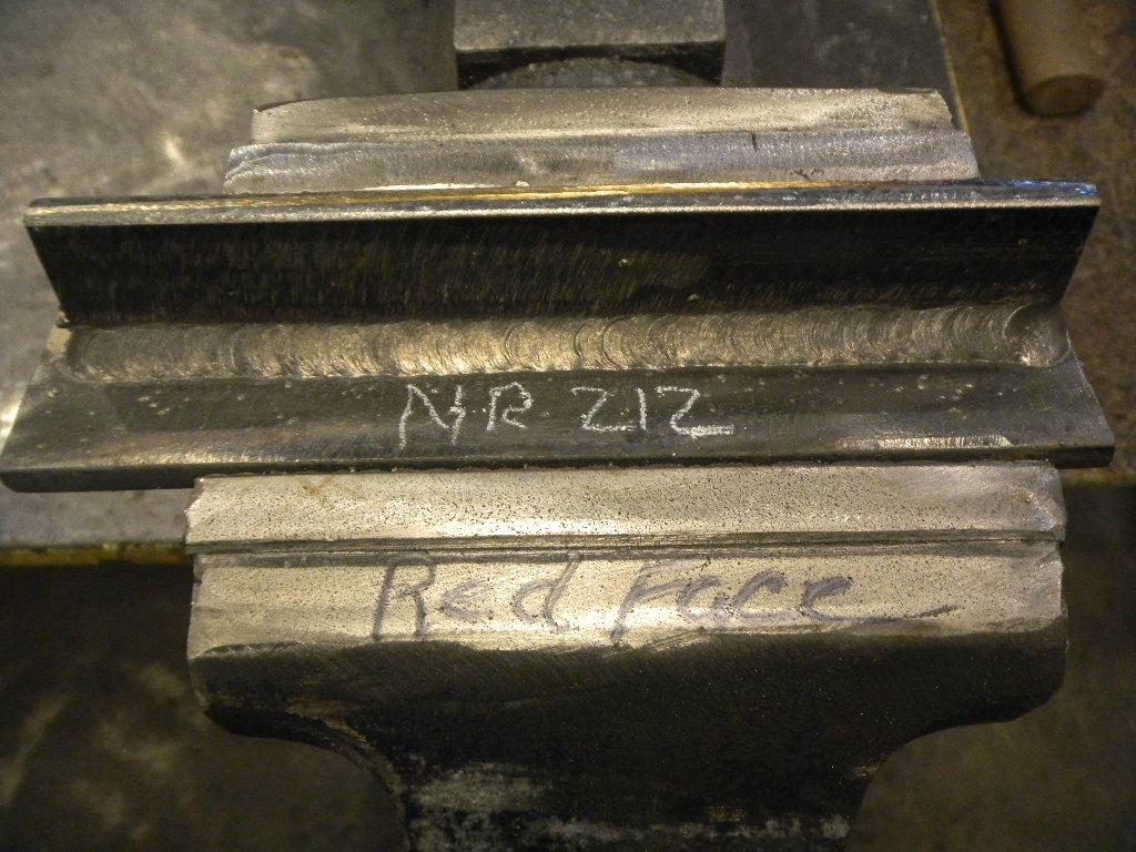

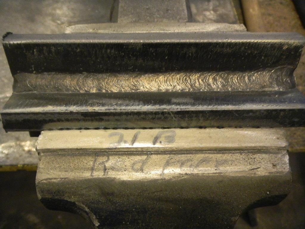

I'm no pro either! When to comes to gas less flux core T-11 wires, my go to wire is Hobart's Fabshield 21-B. Then Lincoln's NR-212. I don't think Lincoln makes it anymore, one wire I would avoid is Lincoln's NR-211! I think Lincoln discontinued the NR-211 wire, and came out with the NR-211MP. I never took a test with NR-211, but have been told several times in testing facilities they have never seen anybody pass a bend test with NR-211. I've taken numerous 1-inch side bend tests with 21-B, and never failed one. 2 or 3 of them I walked out of the testing facility just knowing I failed, but a few days later the job site would get a call saying I passed.:confused3:
