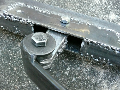

Check out these welds. :) No it's not mine. I didn't do these welds. I can do better. But when I was first starting out with my 110Volt arc welder they looked as bad or worse. I welded a little trailer for my brother when I was first starting out with my 110 volt machine around 5 years ago and the welds are awful on that.
Although my welds on the ball are awful. The welds on the lawn tractor trailer are worse. I need to get a pic before I go over and redo my brothers trailer which he never put to use. lol
