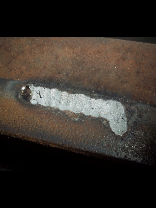

How big was this chunk of cast? How thick was it in comparison the the bead size?
I was welding a piece of 1/4 plate steel to the bottom of some rail road track. The bead was probably 3/8 wide.

Ok so most of each item remained cold? Or did you preheat?
   / Welded cast parts on sickle with a MIG! #14
The joint remained mostly cold, but when it broke it pulled a crater out of the cast iron along the bead.
   / Welded cast parts on sickle with a MIG! #15
image-1145632762.jpg This is the crater. It is about 1/4 deep.

View attachment 425442 This is the crater. It is about 1/4 deep.
So the weld just cracked away from the cast and the whole weld came off with the 1/4 plate? I guess thats what I would expect, and less likely with preheating the cast to dull red.
These clips were so far gone I was suprised they didnt fall apart before, during and after the weld. Because of that I looked for the forging flash ground off or other clues, they're not forged. These clips look like they were cast. One of them was bent, I suppose by trying to cut steel (fencepost?). I would not expect it to bend but rankrank says they do.
   / Welded cast parts on sickle with a MIG! #18
That is exactly what happened.

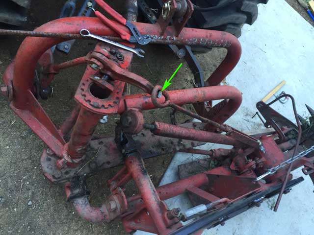

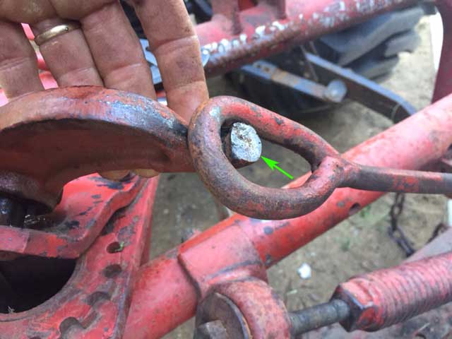

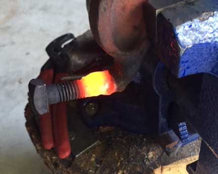

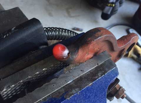

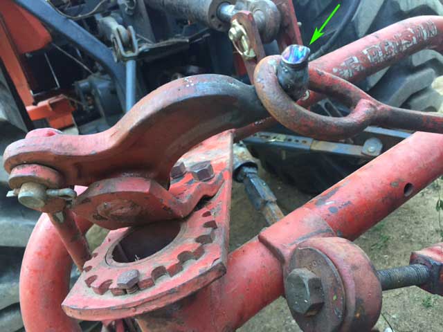

This hook broke off. I welded cast again with the MIG. Wondering if it's gonna hold. This is the mechanism to raise the mower, and provide the ride height above the ground, the hook is essential.
attachment.php
attachment.php
Welded a little dot on the end, let it cool slowly.
attachment.php
Welded an old bolt onto the mild steel dot.
attachment.php
Cut the bolt off to restore the hook.
attachment.php
I will replace it with a hydraulic lift mechanism someday.
