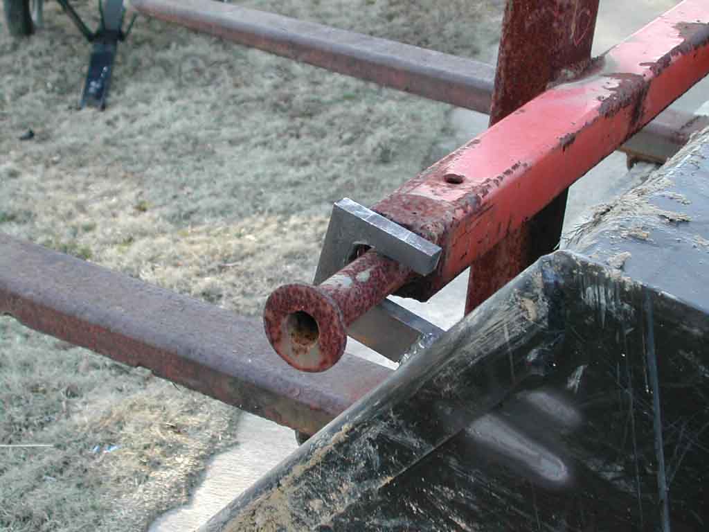

here's a hook i installed on the bucket, removable.

It is hard for me to tell, so I will ask. Is that hook held on by a bolt, and if so what is the grade of the bolt?

Mike, my point is, there is no way THAT tractor will straighten out whatever it is that is welded to that bucket. Not enough hyd. capacity or weight, which determine the tractor's ability to apply force. I don't think there is a hook that is right for all applications, and if someone is using a larger machine, they should have someone authorized to choose and weld hooks on, as the weld will usually be the weak point in amateur installations.

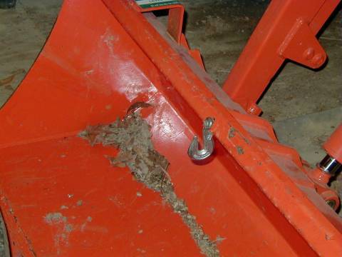

Oh crap I think I over built my hooks for my 30hp tractor.

Actually that hook looks like a hook from a tie down strap. So if that is true depending on what the rating of the strap it came from would determine if it's "safe" or not. I have tie down straps rated at 20,000 lbs. (max) and I'm sure those hooks would be strong enough. Maybe BigEddy could let you guys know where the hook came from and what it is rated.
